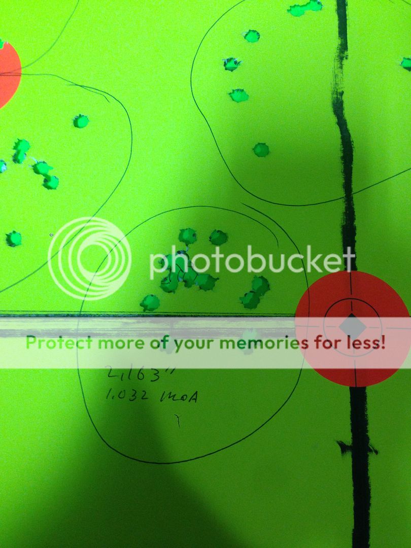

After my success at 600 yards a couple of weeks ago, I got in a quick range session today with my M25. I had 15 rounds remaining of a batch of 175 SMK's that I loaded up. This group was shot at 200 yards with the gas off, single-feed. I chose to single feed because one of these rounds had a case-head separation on my last range session so I wanted to inspect the rounds as they came out of the chamber.
15 rounds, 2.163" at 200 yards for 1.032 MOA. I don't think I've ever shot a tighter 15-round group. We also had light gusty winds, swirling.
