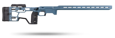

Rem 700 SA, single load, W308 heavy match barrel.
Currently I have a synthetic stock nothing noticeable wrong with it I am just tinkering upgrading.
Target rings only in my mind, mostly shooting BR 300 M and maybe occasionally visit the f-class ranges.
I prefer the forend with arca rail, and the rear stock modular especially the rider, because I prefer shooting with rear mechanical rest as much possible.
When needed I can replace the rear sled/rider.
What brands and stock models would you consider that doesn't necessarily brakes the bank?

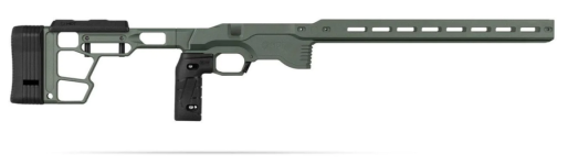

I love the MDT ACC Elite and have several of them now. BUT I couldn't justify 2k for my 22lr, so I went with the MDT ACC Premier Gen 2. $1250, then replace the grip with the elite grip (like $100?) and voila. Is it the same? Not quite, but damn close.
How hard or convenient is to disconnect that rear stock (with the rest of a gun assembled)?
May save me my new gun bag currently using with some difficulties.
To fully remove the rear stock on a ACC Elite involves a large T-handle allen driver (included with purchase of ACC). It requires many turns, perhaps 20 turns; One large allen bolt.
