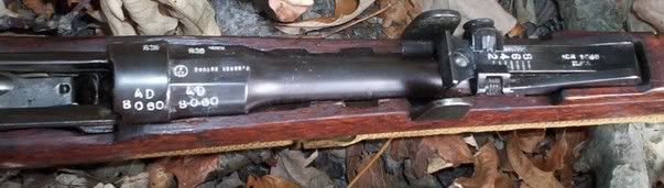

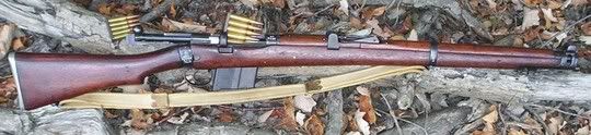

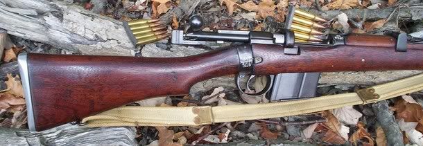

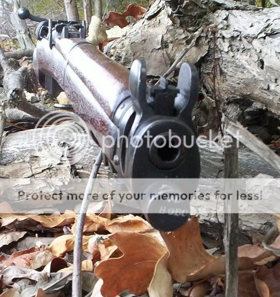

Here's mine , all matching , which is a very welcome addition to my Enfield collection.
great pictures there,
but I have a question, you say all matching, including the nose cap.
I can see the nose cap has the slots for the gernade launcher but I htought it would have had the holes cut in the ears to allow more light on the front sight.
or was that just a lithgow modification
great looking rifle
That's a sweet lookin ishy Timberlord. I'd take one too if they came north. I've only one question: I thought Ishy SMLE's had square eged nose caps to save production time and $$. Did they drop this practice after the war?
My guess is that that was a part on hand when the rifle was built.
Ishapore , as we know , were very thrifty with parts and had a very extensive repair program.
I have 2 Ishy rifles , the 2A1 and a '45 No1Mklll* , both with rounded nosecaps.
My 2A1 is all matching , including the magazine which is numbered to the rifle
As to the nose caps, I have 3 Ishapore rifles.
The Musket is a 1946 conversion on a 1914 Enfield SMLE III; nose cap is rounded.
Ishapore SMLE III* dated 1943, nose cap rounded
Ishapore SMLE III* dated 1948, square nose cap.
