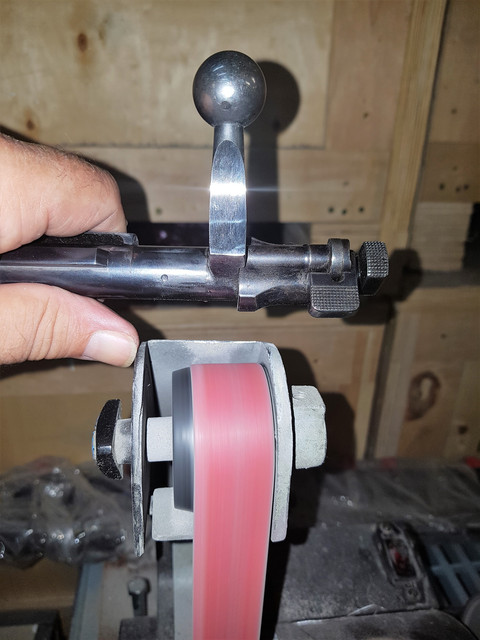

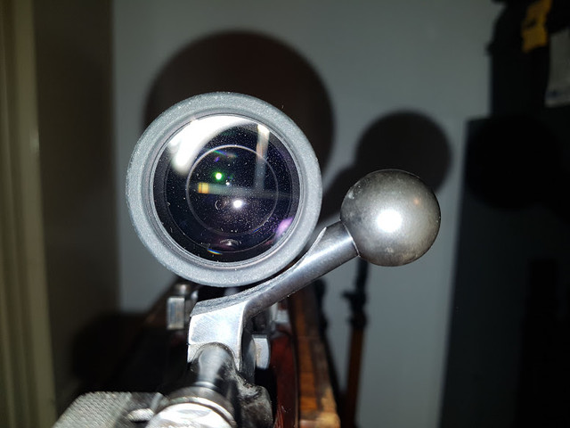

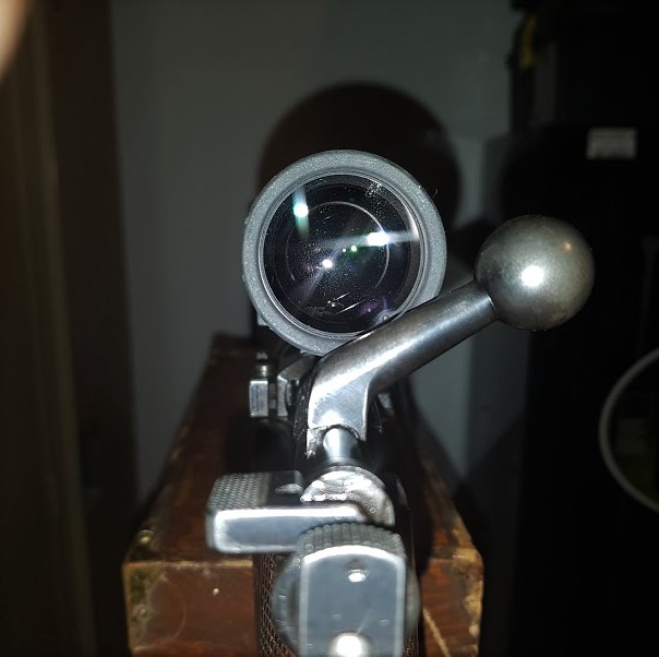

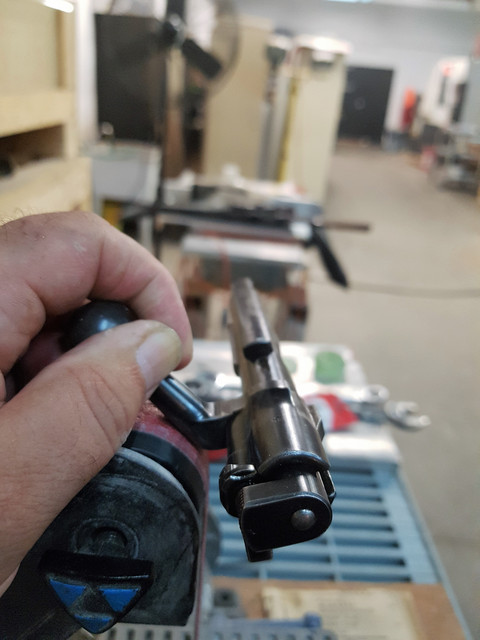

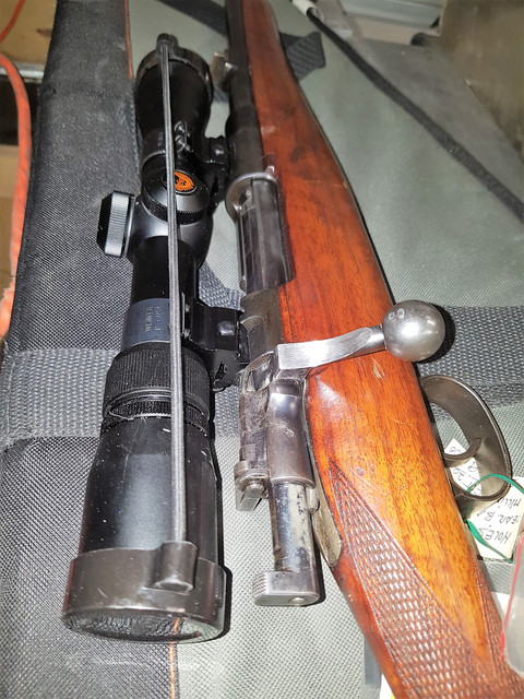

Okay - from pictures - that is not a "bent down" M94 or M38 bolt - that is a cut off and re-welded "scope friendly" handle - much too sharp edged to be by the Swede military. Very similar to ones that I bought from TradeEx. To help you on the ID - CG parts have the Swede crown "up and down" - ie, straight. Husqvarna made parts had same crown, but tilted - sort of 45 degrees - one of the ways to tell the difference. Your rifle stock sure looks like a model or version sold by Husqvarna as a sporter rifle, but the receiver number and stampings say it used to be a Swede military rifle - so maybe both - started with military, then made into a sporter by Husqvarna.

That is interesting. So far as I know, the serial number after the Inspector Initials was the original one. So this one has two serial numbers. The original one, if six digits - starts with 120###. Again, from that Crown Jewels book, that receiver, inspected by "K.B." was made at CG arsenal in 1902. (p. 147) I do not know where the second serial number shown comes from - the six digits ahead on the inspector initials. Would be helpful if someone knows what that is from??
I do not know enough about the history of the Husqvarna production. For certain, before they got the WWII era contract for the M38 rifles for military, they were making hunting rifles. It would not surprise me that they used surplus military receivers from Carl Gustaf Armoury, before they started making their own? Just a guess. I do not recognize that right side safety as a Husqvarna thing, but have bought at least one of those trigger units through CGN some years ago - was told by seller that it was made in Sweden - an "after market" piece, I presumed. So, between the safety that it has and the "scope friendly" bolt handle modification, someone has been working on it - I do not think either of those features came from the Husqvarna factory.
