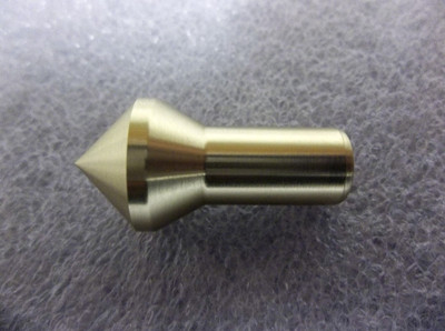

Not sure about your concentric scratch, but if it's crown that needs a clean up. You could make crown-lapping-tool with a brass screw.
- Then have at it with valve grinding compound.
Or buy one online

A couple of your points - above - "roll the barrel" - so that presumes that the bore within the barrel is perfectly concentric with the outside of the barrel - often it is not - is often the cause of off-set crowns - indicating on the outside of the barrel, and assuming that is concentric to the bore. I have and use a hand crowning tool from Brownells that uses a brass pilot into the barrel - steel pilot are also available or can be made - so those pilots ride on top face of the rifling - perhaps 3 cm or more long - is sometimes a fussy thing to make a pilot on my lathe that is a nice sliding, snug fit to that rifling diameter - but the cutting tool is indicating off the top faces of the rifling - not the outside of the barrel. A friend borrowed the tool - had a snug pilot made for his muzzle - I have same rifle - when I got it back, that pilot would not go into my muzzle - needed no more than a "polish" in lathe with some 320 grit emory - but that was enough to be the difference between it going into mine, versus not - my rifling diameter versus the rifling diameter in his barrel.
The last barrel that I did was a 9.3x57 barrel that was cut back to 20" length - I did not have a .36 whatever pilot, so started with one for a .375" barrel (from Brownells) - required multiple trips to lathe to get just enough for lubed, sliding slip fit into that bore - and muzzle "looks" fine - was 9 degree crown, and I finished with a very tiny touch with 45 degree cutter - just enough to break the edge of the grooves at the muzzle - that meant there is larger 45 degree faces on the four "riflings" - but makes a continuous sharp edge all around that muzzle to let go of that bullet, evenly.
Concentric scratch marks - maybe at very fussy levels of target shooting, it is possible that any marks on the face of crown might be significant - was a thing some time ago about a "target crown" to be cut at 9 degrees or something. Is actually the precise edge all the way around the bore and rifling that is of primary and first main concern, I think - so that the barrel lets go of the bullet - all the way around - at precisely the same time - does not "hang on" a few thousandths more on one side or other - more or less definition of "perfectly" right angle to the centre of the bore line, which since bores are not guaranteed to be centered within the barrel - can mean that the "perfect muzzle crowning" might not be centered on the barrel.

All the barrels Ive ever cut were flat and square any relief would be to protect the crown.
Once cut I would is a brass round head screw and valve lapping paste to remove the burrs.
I also check the end of the barrel inside diameter for oval with a bore gauge. I sometimes use a die and press to add a little choke which sometimes helps.
I just finished crowning tree out of four barrels with a brass screw.
Pushed some pellets through, and I had to re-do one crown the very first I did, I had maybe a way to high RPM and that pushed a material inside and developed a wire edge.
