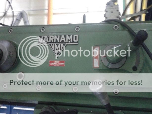

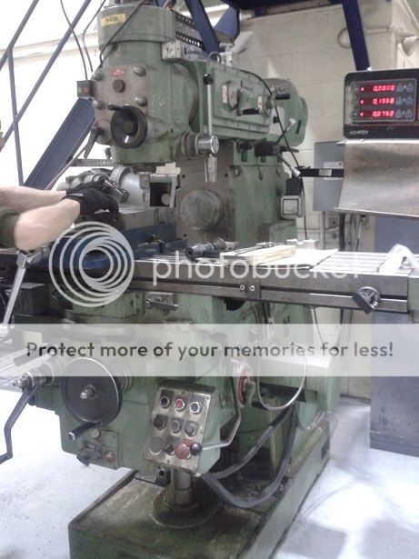

After a few pm,s to Hungry for technical advice , physical reassurance and emotional support I went out to the shed out back and fired up the ol Varnamo milling machine .

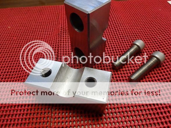

Due to the barrel having a different profile on the bottom the barrel vice has to be shaped correctly on the bottom half.
Here the angle is being cut into the bottom block at 45 degrees and the gap measures 1.1 inches wide
You can see the bottom half of the barrel vice is cut out more to fit the barrel correctly

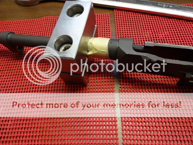

Here is the barrel vice in position and you can see how the top block grabs the barrel and prevents the barrel from turning while in the vice..

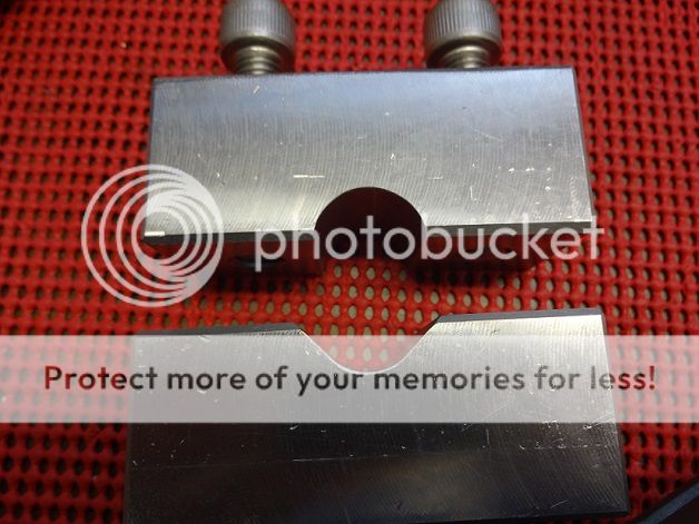

When I went to use the vice for the first time I couldnt get it to tighten up enough onto the barrel ??????? Well having both blocks threaded is not the way to go ...lol .
After thinking about it abit I took my big ass bubba round file to the threads in the top block and removed all the threads. I was a little hesitant to go at it with the file after all the high tech machinerey made it but that fixed it and the indexing job was pretty anticlimactic actually .

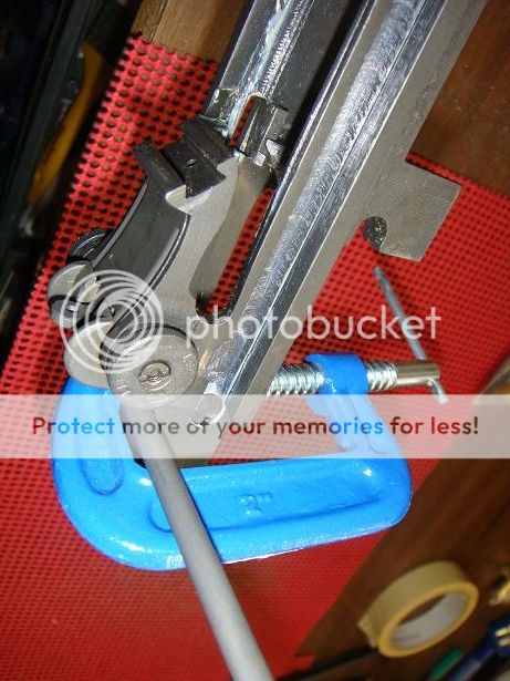

The only issue was not being able to use straight edges for the job as both of these rifles have threaded muzzles so there isnt a flat edge to use like the original style flashiders have .
I just went with the gas system being inline as best as I could get it.

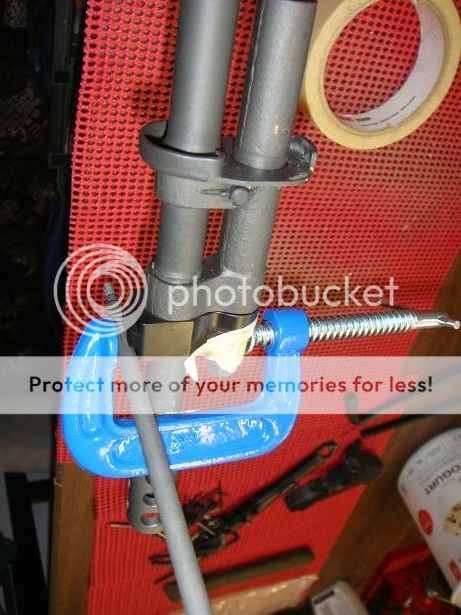

I didnt use any rods at all....just put the barrel and gas system in the stock and eyeballed the rifle from the front to ensure the gas system was now lined up straight . I had to take the rifles and vice apart a couple times and index the barrel again to get it to line up correctly . Its alot easier job indexing the barrels that still have the flashider cuts in them .
It cost me $25.00 for the steel and a Timmies card the guys in the shop !!
When putting the rifles together today I noticed the gas lock front sights on the Socom and my other version both have nice flat edges on top !
So used Hungrys trick of using some spare m-305 cleaning rods (6 sections) for the paralells .

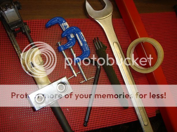

Heres the tools required ( the wrench has one end cut off so it can slip into the red cheater bar )
