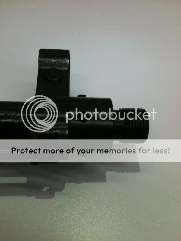

Heres an easy way to have a threaded barrel, a SKS to AK threaded adapter:
Now you can fit any AK brake! The screws sit flush when tight.
