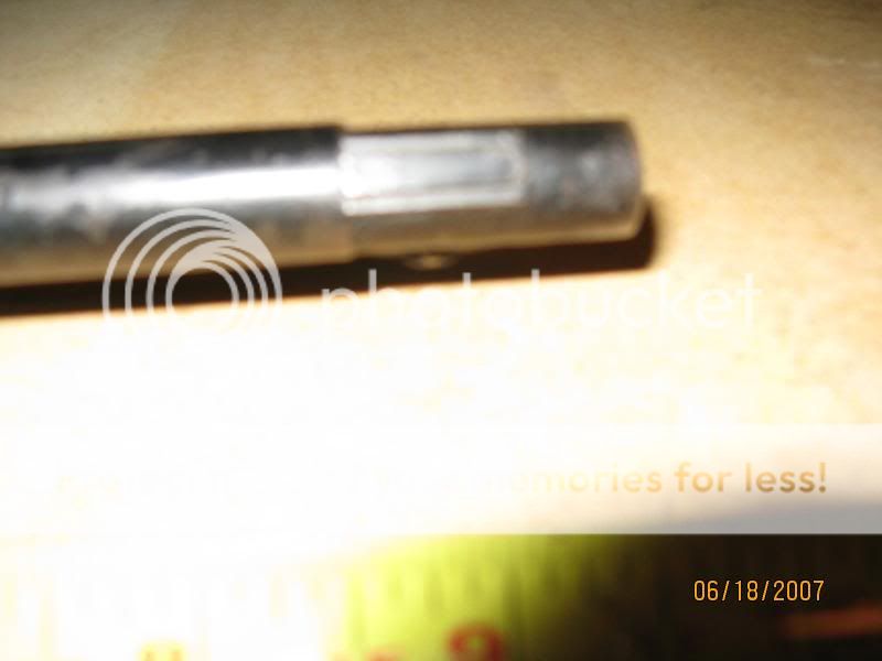

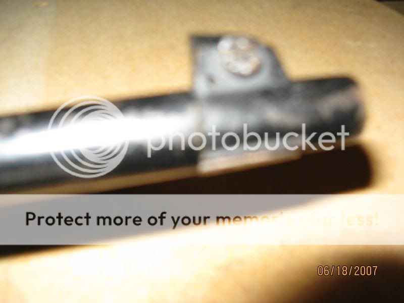

Here's a couple picture of what I think is the ground off bayonet mount.

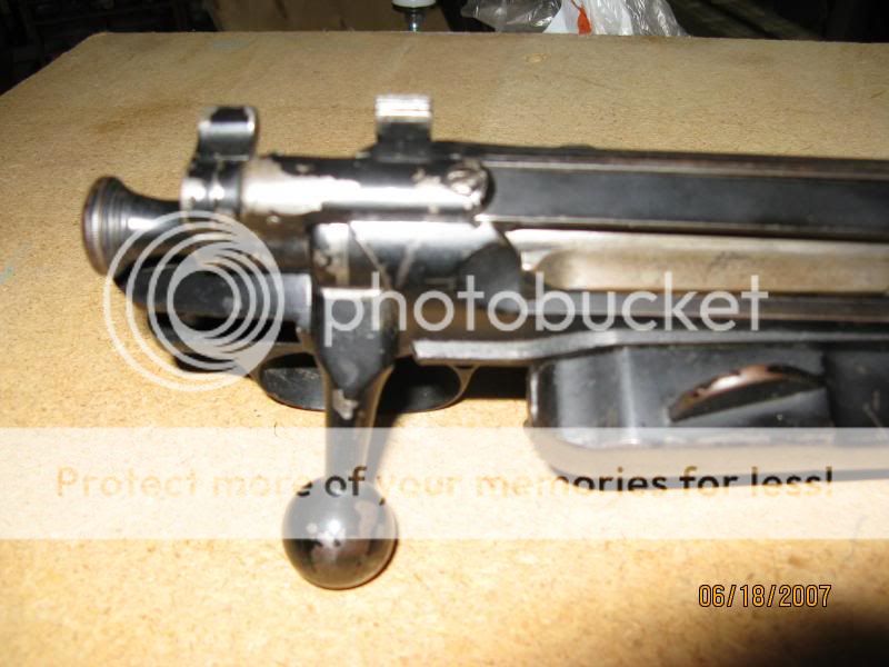

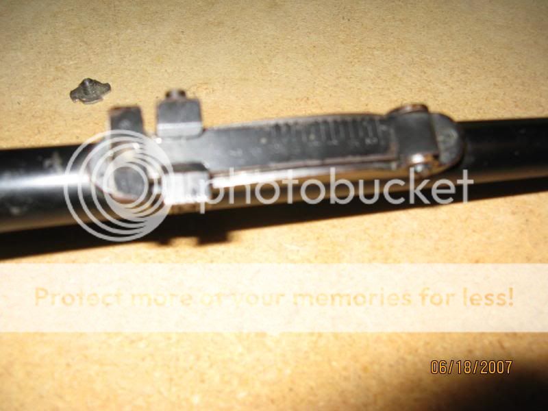

A couple of other pictures for fun.

I've been looking into this some more and have a couple of observations. The ground off mount looks to be too short to be Norwegian, but does look like the picture of an American mount that I’ve seen and the only 22" barrels I can find are America. So now I'm wondering if it's possibly an American 30-40cal Krag barrel mounted on a Norwegian receiver. Does any know if this is possible? Also I'm been assuming that this rifle was 6.5 x55 Swede, but now I'm wondering if it's possibly 30-40 Krag. Would any one in the Vancouver area have a single 30-40 Krag brass they would be willing to sell so I could test fit?
