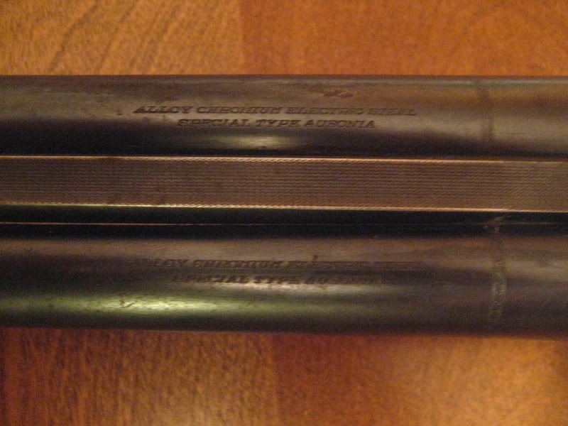

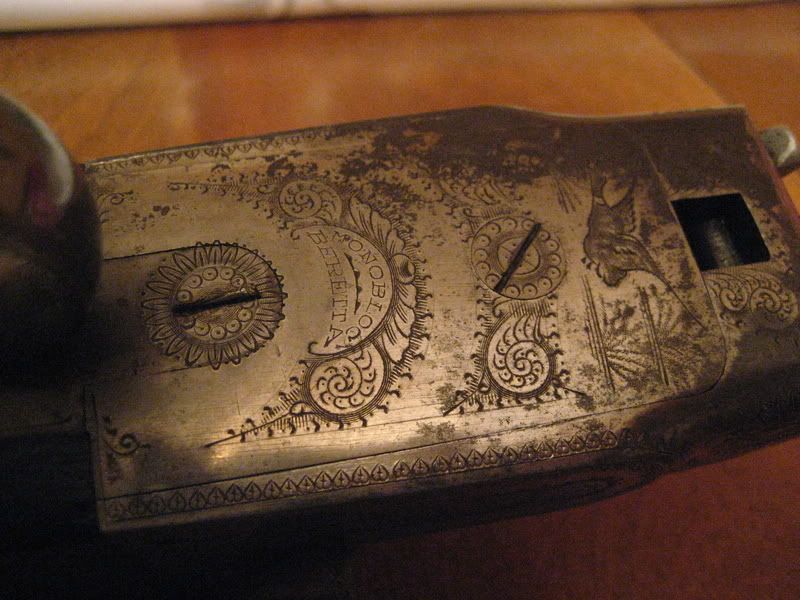

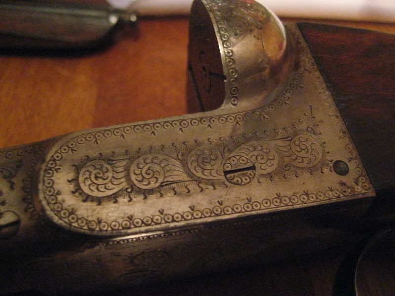

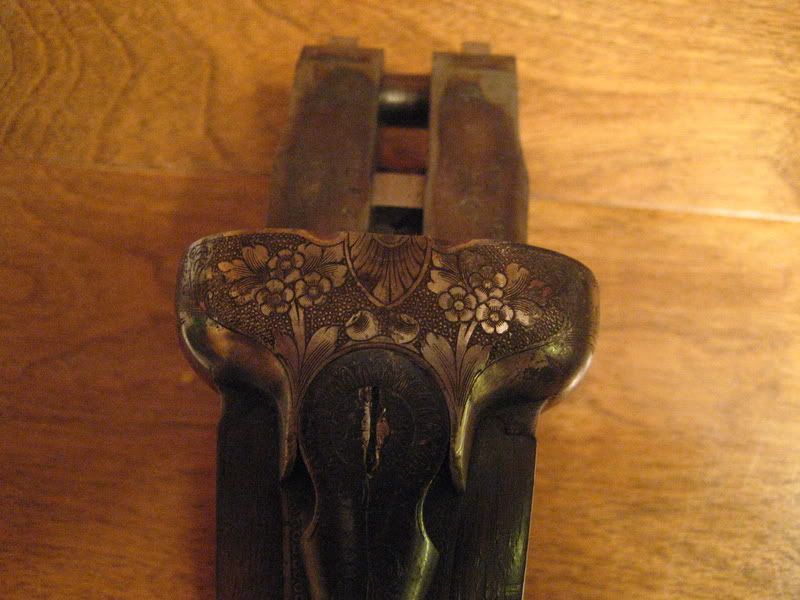

I'm trying to ID this for a buddy, but I can't seem to find any model number on the gun. So I took a couple of pics. Anybody have an idea on the model number (12g SxS, boxlock, double trigger)

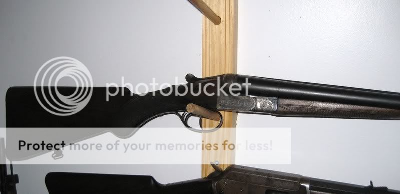

I just posted a few posts up from here...In my case, I think the model number is stamped in the wood in the forearm. My confusion comes in the fact that the Silver Hawk is Model 410, mine is model 408. Perhaps the below will help you, I found this info on another forum:

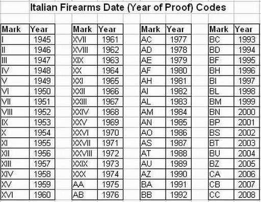

KK, the gun looks to be a model 409 PB, which was produced in various guises between 1934 and 1964. Look for a date stamp and compare it to this table:
Sharptail
I agree that this looks like a 409PB. I noted the details of one of these once owned by a friend. It was in the 30,000s serial no, and had Italian proof marks of crown over PSB, crown over crossed rifles and crown over finito on the receiver (the finito meaning it was delivered to the proof house unfinished, which was common). There was no date code stamp on the receiver. The crown means pre 1948, and apparently the absence of a date code usually means 1944, when the Italian war had finished and Beretta in Italy was once again able to resume shotgun production, but before the present sequence of year codings had begun. The proof marks beneath the barrel were identical and the serial no was the same, but in addition there was the Arabic number 12 and a smaller number which seemed to read 950 or 1950. I have no idea what this means: perhaps it was a date, 1950, and that was when the gun was actually put together, but using pre-1948 proofed barrels. All of the component of the gun were matching serial numbers. The question would be resolved if it were possible to date the serial number, but this information is no available as far as I'm aware for the 409PB.
A good condition 409PB is a beautiful gun and I think something of a treasure if you've got one. The workmanship and quality of these guns which were produced for a 'mass-market' compares to much more expensive English guns. Maybe yours can be cleaned up - a little bore gel or solvent applied over the receiver can work wonders. I haven't seen them come up for sale often as they are such nice pieces and when they do I think they get snapped up. They still can be got for under 1000 but with the increased interest in SXS in North America and especially in older quality guns the value will surely go up.
Beretta "409PB" 's were generally marked with the model number burned or etched into the concave/grooved surface of the forearm ( that portion covered by the barrels.) These guns were made from c. 1934-1964.
409's were made in 12,16,20 & 28 ... 27-30" barrels with a variety of chokes, double triggers, plain extractors and "P-o-W" style pistol grip stocks. 410E's were of somewhat higher quality & finish, fitted with ejectors. 411E's were a more highly finished version yet, with false sideplates.
