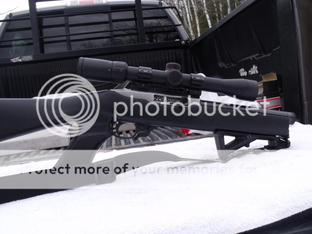

I got this dlask 8" barrel and dlask receiver with Kidd parts that I'm not totally sure what I should do for stock wise. I had a new Boyd's blaster stock that I shortened but it's so fat looking on the forend it kinda looks funny. Need ideas. It's a fun to shoot rifle but if i can't find a nicer stock or idea I may just sell or trade the new barrel off for a lightweight barrel
The stock is a factory carbine stock that I modified.I shortened the forearm,routed a flat for a picatinny rail,removed the grip and made a pistol grip out of poplar,used bondo to fill the voids and removed quite bit of wood with a rasp.I also bedded the receiver with JB weld and pillar bedded the action screw.
