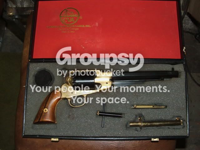

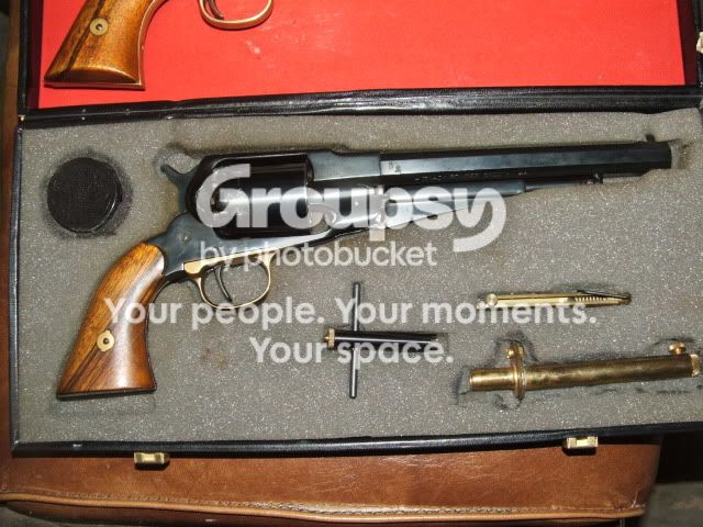

Here are pics of my latest acquisitions. The RAG appears to be unfired! Apparently, both these revolvers were owned by a movie production company and only used as props. They were given to a friend, by this movie production company, as payment for borrowing some of his collection of "jail" memorabilia to use as props, while filming here in Sudbury. He then sold them to me.
First, the CVA, replica Remington 1858, cal. 44
and the RAG, replica Remington 1858, Cal .44
