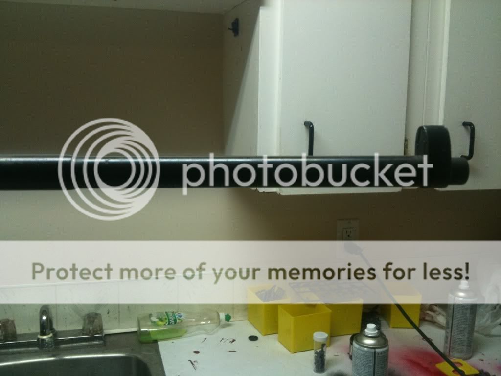

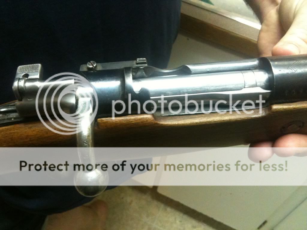

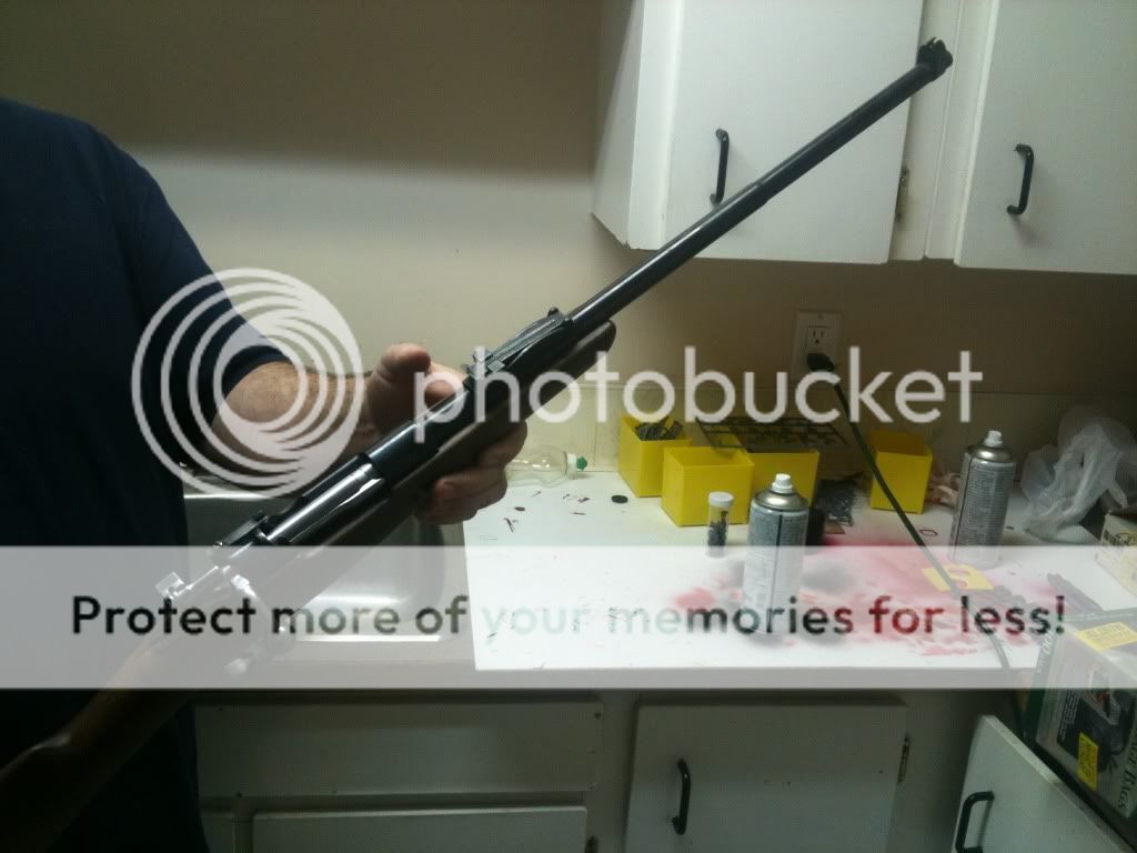

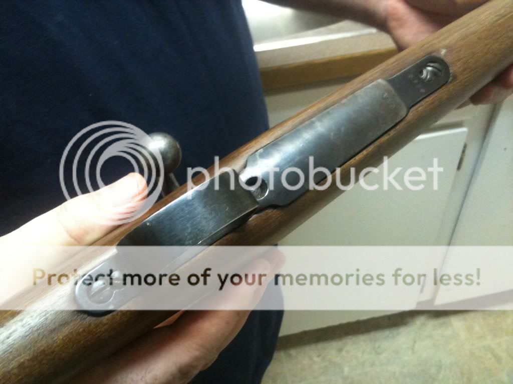

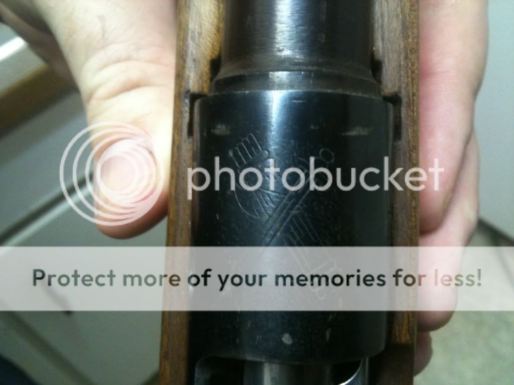

Hey guys my buddy just picked up this rifle through the grapevine. I think its italian military, sporterized by the looks.*
Any insight would be helpful.*
Cheers, Mclean
X2 Spanish Model 1916. Some were converted to shoot the 7.62CETME round. Be careful with that rifle. The chamber is identical to the 7.62x51 but the cartridges loaded for it had lower pressures an a 112grain FMJ bullet. With the right bullets, they are very accurate.
I won't tell you not to shoot 308Win out of it but I will caution you that the rifle was never designed for a constant diet of cartridges that generat around 60,000cup.
Handload to around 45,000cup and all will be well.
Lest I forget, there are also a few around in the 7x57 Mauser chambering.

FR 7&8 were for the Guardia Civil. The Fasces marking shown is theirs.
