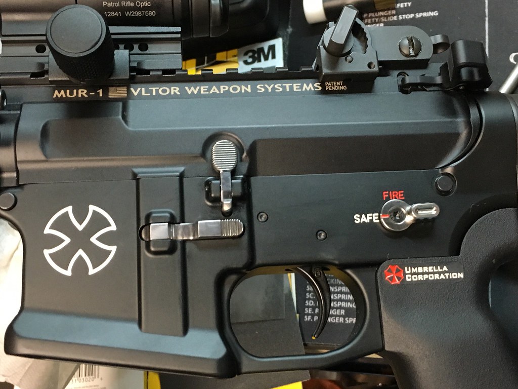

I've got the Vltor MUR upper on my Noveske lower. It's a pretty nice upper.
