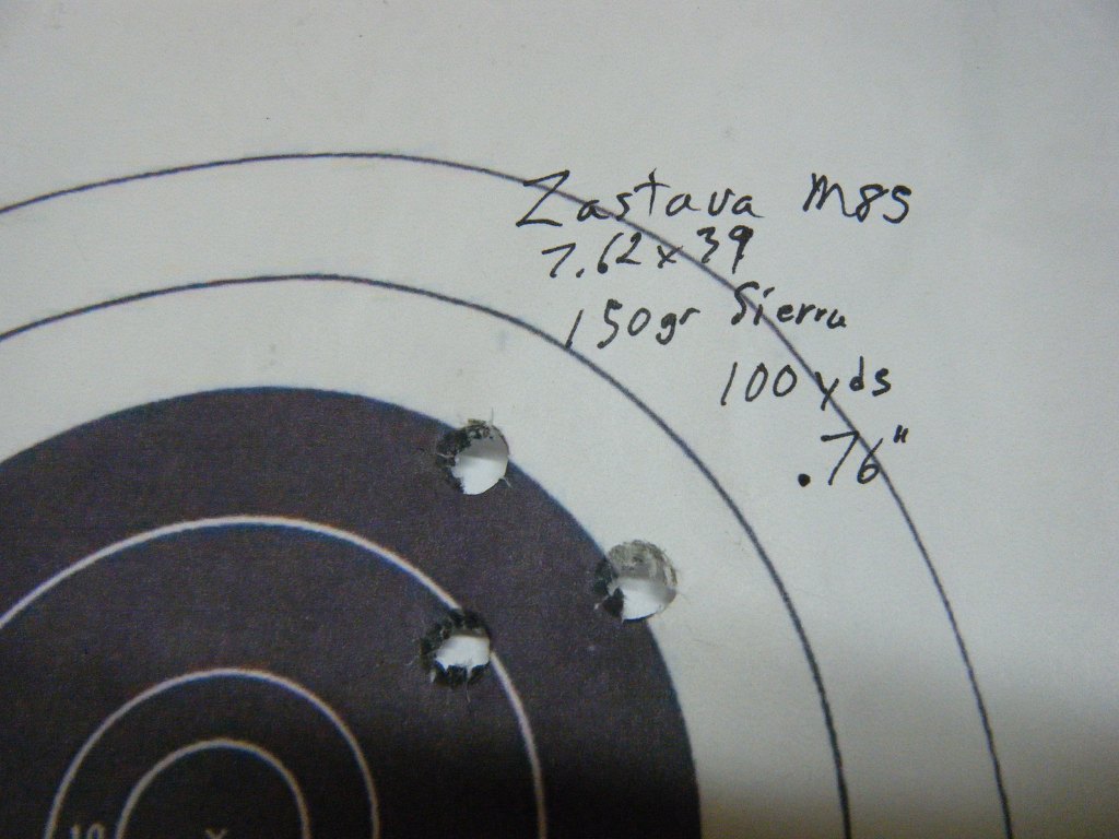

A set of Talley Lightweight rings to replace the cheapo ones I installed originally and we were off to the range to test the results. Accuracy with the 150gr Sierra loads before the bedding and free floating ranged in the 3-4" mark with no groupings going under 3". My son fired off 5 rounds of the reduced recoil rounds for practice and then I shot a 3 round group with the Sierra loaded ammo. Below is the result:
I know one 3 round group isn't concrete evidence it's going to shoot like this all the time but it never even came close to this kind of accuracy before so I was pretty happy with the results. We will be doing a lot more shooting in anticipation of spring bear season and I plan on working up a load using some 130gr Woodleigh's so we'll see how it does over time but I'm pretty confident it will shoot consistently better than before. Overall the rifle is a pretty decent little hunting rig if you're willing to do some fine tuning.
