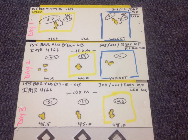

Here’s all I could find of some 100M groups with both Varget and 4166. The two Varget groups were .5 but looks like the load development with the 4166 was a bit better on the days I shot.
