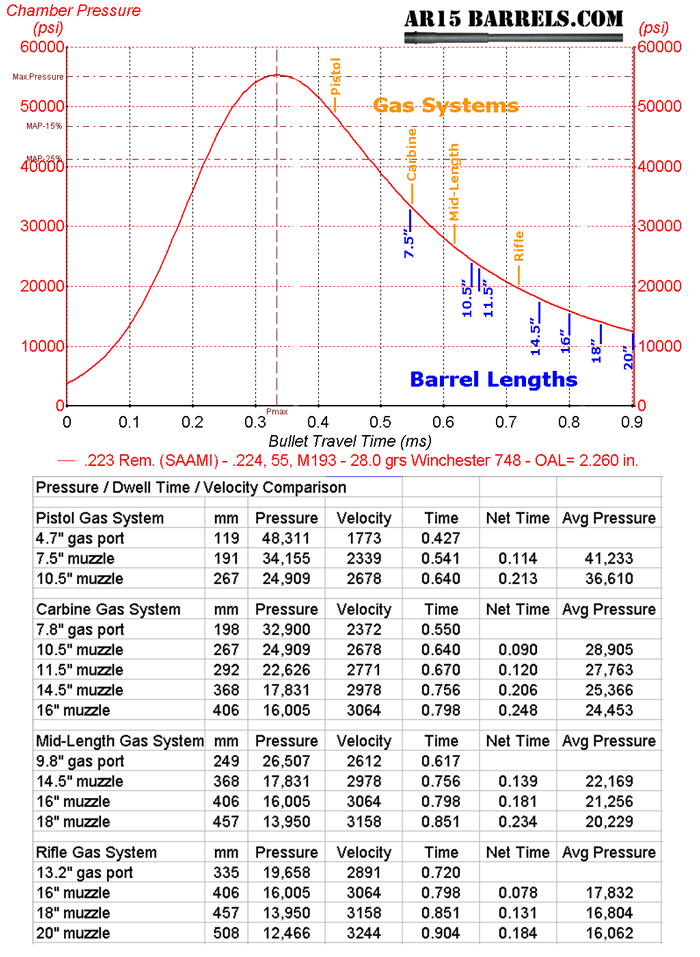

Charts below from http://www.ar15barrels.com/prod/operation.shtml
How the AR-15 Direct Impingement gas system works
Below tells you a great deal about using faster burning powders and port pressure.
