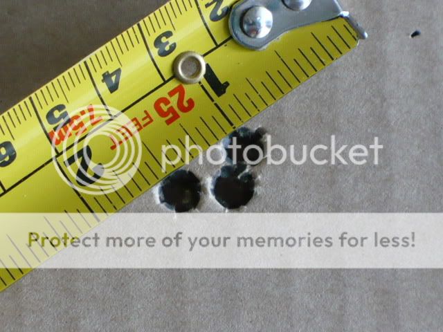

group from my Ruger #1

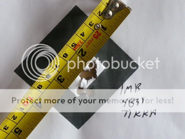

group from my Tikka T3 (7 shots)
The same load was fired from both rifles on the same day.
56.0 IMR 4831, new WW brass, WLR primer, Remington bulk 130 grain bullets.
2.848" to bullet ogive measured with Stoney Point tool
