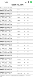

Recently, I got an 8LB keg of IMR8308XBR powder and was wondering if anyone had tried this powder in an M1 Garand. The burn rate is just slightly faster than H4895 which I've used for many years. Unfortunately, IMR/H4895 seems to be very hard to get nowadays. Hodgdon's reloading website does nor list this powder for the M1. If anyone had any experience with this powder in an M1, I would appreciate any info.
