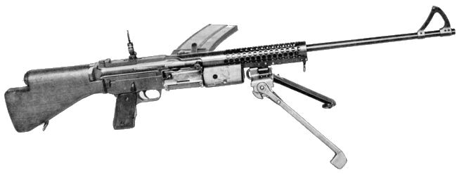

The Johnson Light Machine Gun might be viewed as a transition species, as the barrel, action and recoil assembly were in-line from the muzzle back through 3/4 of the stock, but for some reason the buttplate was then mounted below the bore axis, taking away the in-line advantage right at the end.
It looks as if there's a removable endcap on the buffer-tube.
Maybe they were worried about not having access to the action, with it fully enclosed inside the stock?
