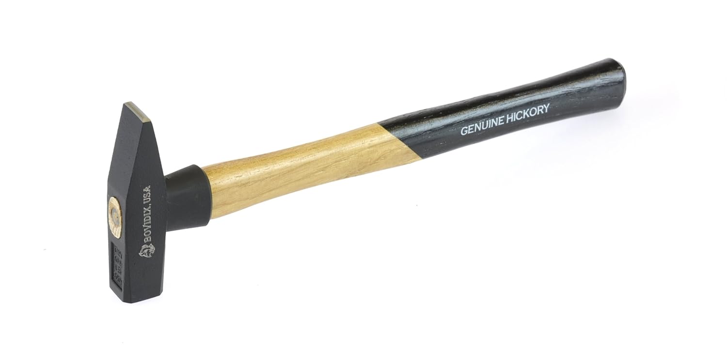

As silly as it may sound, I've gone through maybe 20 hammers in search of "the one", over the last 20 years or so, that I would consider the ideal gunsmithing hammer.
I've tried everything from 4, 6 and 8 ox ball peens, tack hammers, jeweller's hammers, etc. A friend of mine a German-trained master gunsmith and he put me onto 8oz rivetting hammers as his "go to".
I've tried a few now and have settled on what I now think is the best bang for the buck in gunsmithing hammers, the Bodovix 8ox rivetting hammer.
It's got a forged 8ox head, a polymer shaft guard and a nicely formed hickory handle.
You can even find it on amazon for under $20 - amazing considering its competitors are largely sold by european vendors and cost 40 euro and up.
What hammers have you guys settled on as your favorites?
I also still have a variety of 4ox and 6ox ball peens, but I find I use them less these days.

OP, just so you know, the hammer you show is an excellent tool for most jobs I do and I full approve of your choice. Just don't make it do more than it was designed to do.
