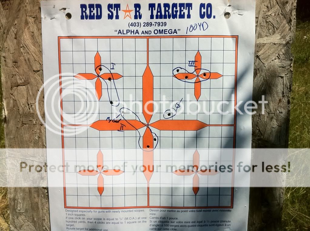

2. Bulk ammo is not precision ammo...
after picking up a "battle pack" of 500 MFS 55g Mill spec .223 rounds, and shooting them off, I do not get very good consistency at longer ranges. However, this is good enough for me to practice my form and my trigger control at first, and while I only shoot 20-30 rounds per session and only 1-2 sessions a week I should be able to save up for a beginners reloading kit so that I may start tweaking my rounds to just the right flavor.
Results of shooting at 125 yards, the sheet says 100, but I wrote that before realizing that the grass at the 100y line was about 5 feet tall... I moved the target to a top of a small hill with much shorter grass.

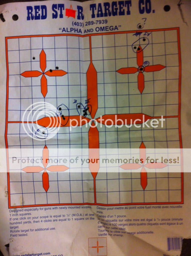

3. Bore sighting at 25-30 yards makes life wonderful...
After a terrible first experience with my new rifle, I came here and did a search for some sighting in info, and came across the basic bore sight. Remove bolt, align bore on target, adjust scope to match. First shoot put me within 4inches of my target, which is much better because I was about 2.5 feet high at that distance...
Pic of my target at 30ish yards

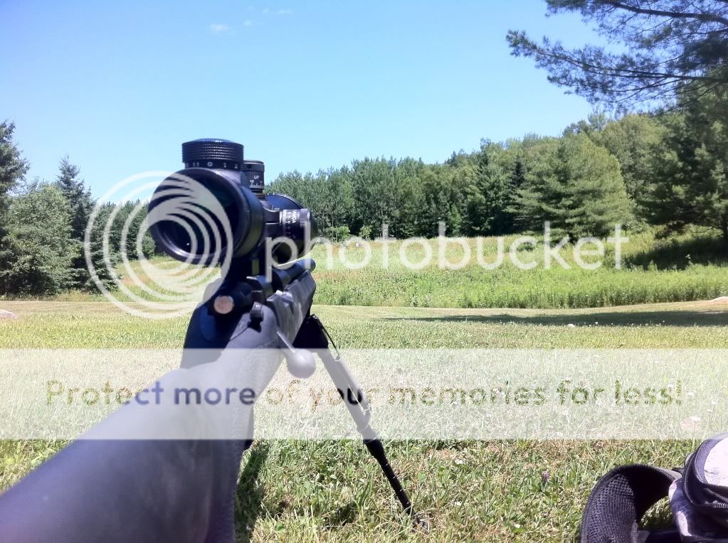

7. Shooting bags are a must, at least a rear one!
was trying to punch holes at 150y with my setup and I found a hard time sticking on the X with only my bi-pod working... I created a make shift rear "bag" with what was available at the camp, was very Red Green...
Beginners shooting kit :redface:

All other things being equal it is usually more comfortable to shoot from a lower position. Until you get a rear bag you can use your left hand as a support, either balled as a fist or holding the toe of the stock between your left thumb and your left index finger. This means the butt of the rifle will be nearly touching the ground -- adjust the height of your bipod to make this so.
Sometimes for various comfort reasons it is necessary to shoot from a higher than conventional or lower than conventional position (e.g. to get a comfortable head/neck angle, or face position on stock, etc). Nothing wrong with this.
