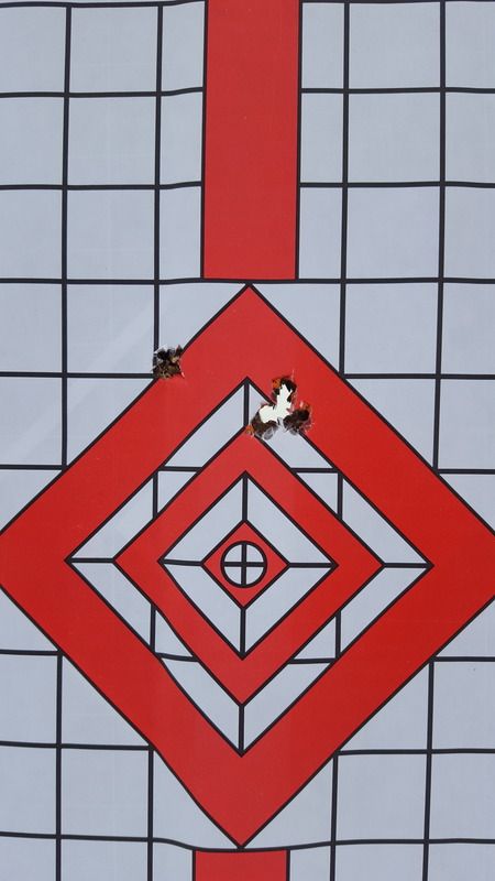

140y 5 shot group using a no.1mk3 with 2.5x scope and a barrel that was installed in 1935.
Factory mkV111 CDN ammo.
And Like Lou said, before the naysayers emerge this was witnessed : )
