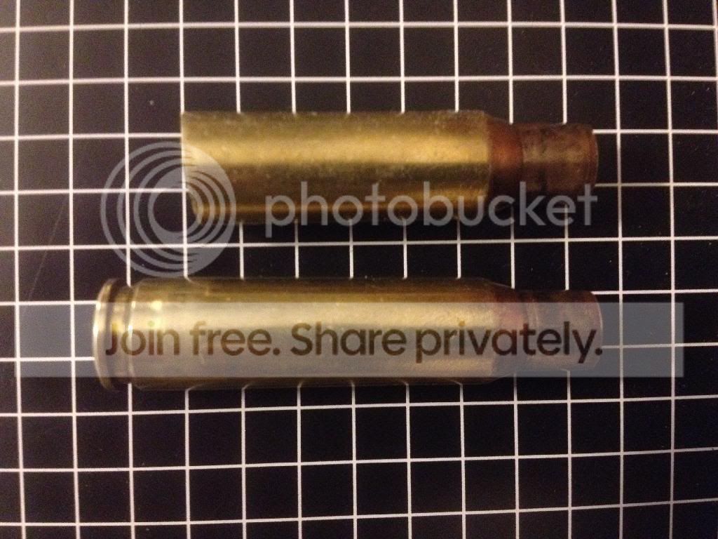

I loaded the last round into the mag and fired it and I heard that the case didn't sound the same as the others when it hit the wood.
This is what I found.
The other half was nowhere to be found. It is a Winchester case and the neck thickness is 0.013" and the body thickness is 0.028"
The case was only reloaded 2 times so it was on its 3rd firing.
I checked the other 99 cases with a paper clip and I didn't find any ring inside any of them.
Load data was 41.7gr of IMR4064 over a 168gr SMK with a FGMM 210M primer loaded to 2.800" OAL.
The case was sized for the headspace of my M1A National Match which is 1.631" but was fired in my M305 who's headspace is. 1.638".
I think this one is on me.
