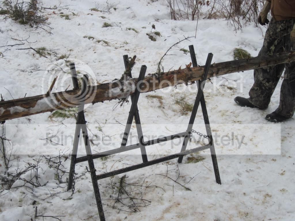

I was just going over the pics of our last trip. I lucked out; I went with some guys that were real pros and hardcore hunters and they knew their way around a camp! They had EVERYTHING and that trip threw EVERYTHING at us. I got my truck stuck, we got torrential downpours after a blizzard - and we STILL managed to bag a moose!
In any event this thing is THE BOMB:
Cripes - you knock down a tree, throw it on this thing and you start sawing on one end, your buddy starts on the other and before ya know it you have enough wood to fire the campfire and the tent stove all night long! It is light, strong and fits in with all the other crap in the back of your truck when you head out!
