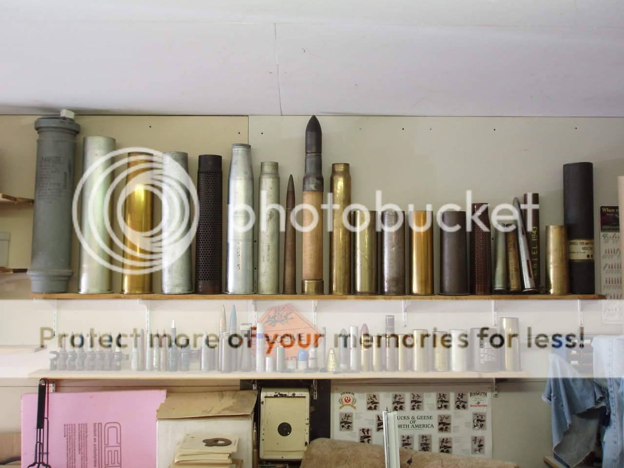

one way is to know your projectiles, early war AP rounds will mostly be solid steel, perhaps with a tracer component, the tracer part wont go boom, it just burns, another way is to look for drilled ammo, it will have a hole drilled into the explosive cavity of the projectile, another way is to buy practice rounds, they are typically blue.
simply knowing what you want before you buy will help you greatly, i buy ww2 commonwealth tank gun ammo, i know what the types of projectiles look like, i know what the cases look like, etc. if i came across anything that looked like it was HE or HEAT or anything that involved a fuse, i would want to see it taken apart first before it came home with me, i would also accept a cutaway version, if it was anymore than a fired case and it wasn't my main interest of collecting, i would probably not touch it
as long as you don't go picking though dump sites(these are all over Canada they thought it was a good idea to dump unused ordnance and that dose not account for the stuff used in training that did not go off) you should be good to go
