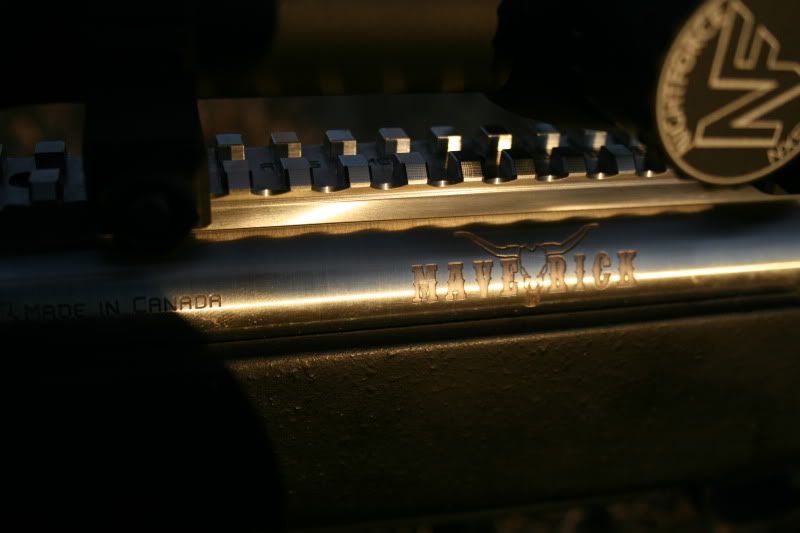

Some photos of 2 finished rifles that have been thoroughly tested and extensively shot.
Top rifle is a Maverick in 338 LAI , the lower an Infidel in 308.

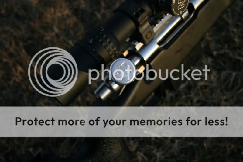

A close up of the bolt knobs that will only be offered on our rifles. These will not be available for install on other rifles.
