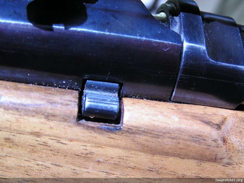

Finally, on the left side of the receiver, if there is only a very samml tab as a bolt release catch, it's a 1640, wich is very similar to the FN M/98, but of the Small Ring Design. Actions screws are 8.750" apart one from the other and have a hinged floorplate, of alloyed metal or steel.

The picture below is the bolt release latch of the 1640 series;
