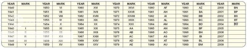

The date code will be stamped on the bottom of the barrel in a little rectangular box outline. Either Roman Numerals (before 1974) or letters will be stamped within the box. This code determines the year of manufacture as utilized by the Italian Proof House.
Either consult the resources on ShotgunWorld or let us know what the date code is and we'll help. Good quality photos, particularly of barrel and action markings would be of even more help to determine the model/value.

Beretta used Roman numerals from 1945 through 1975, add the roman numeral to 1944 for the DOM.
Just to "flesh out" the list Mark so kindly posted ...
Some older Berettas were also proof-marked XIII (1935) through XXI (1943).
No proof codes for 1944. For 1986, other Italian made guns may be marked AP.
Finally for 2005 - BZ, 2006 - CA, 2007 - CB, 2008 - CC, 2009 - haven't see one yet, but best guess "CD", however, the odd time, sequential letters are inexplicably skipped.
