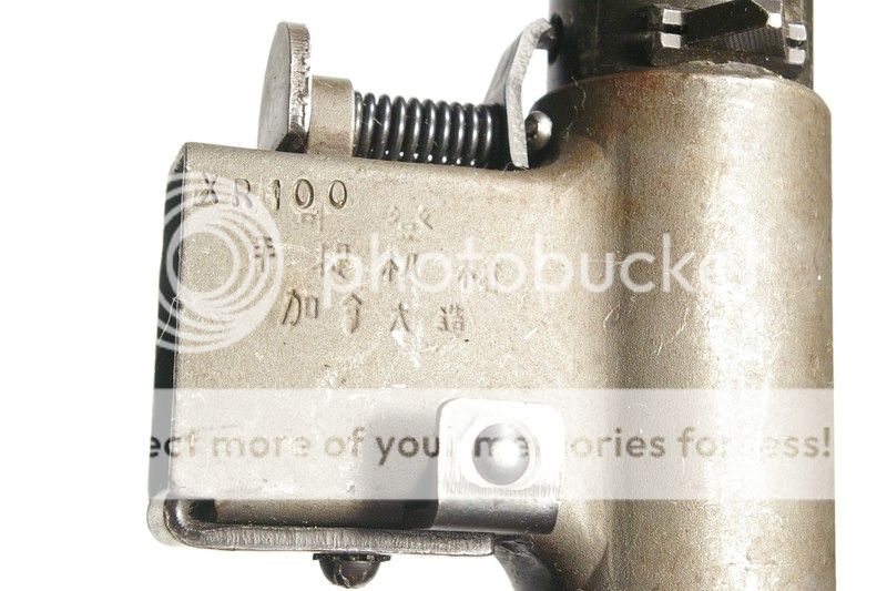

I have seen hundreds of the chopped Cdn stens with the Chinese script. The serial numbers are usually in two or three batches. The earlier Chinese script sten batches in the 8L, 9L and 10L series are rarely seen from Cdn service. Seems to me there may have been some 6L chinese marked as well, but I'm pretty exhausted right now so I can't be sure.But not all the 8L, 9L and 10L stens were chinese marked. I imagine most of the Chinese script ones from these batches went over. From somewhere around 11L3000 until the end of production all the Cdn stens had the Chinese script. These are usually the ones you see form Canadian service. It would seem even the spare magwells that went into store at the end of production were also Chinese script. I have seen a small number of Chinese script bodies without the usual serial number, but instead have an XR serial prefix followed by two or three numbers. I have also seen the XP prefix on one British magwell, but no idea what the modification or difference was, or the significance of the XP serial.

Wandering a little off topic here, but below is a shot of one of the XR prefixed stens, this one listed for sale at collectors source. They do not have the usual "L" serial number.
