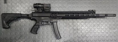

The R9 Mk1 arrives in a fairly short, plain cardboard box containing the Carbine, the QD Buttstock, one 5/10 rd Magazine, a tube of lubricating Grease, an Owner’s Manual, an SAI-branded Trigger Lock and a couple of Stickers. The Buttstock must be carefully aligned with the Picatinny Buttstock Rail in order to slide it onto the rear of the Carbine. Once you get it aligned, the Stock slides easily onto the Carbine, clicking into the height position of the firer’s choice. The Buttstock can then be slid forward and back with 6 standard locking positions. Note that the Polymer Magpul Buttstock on my Test Carbine was extremely tight on the empty Buffer Tube, to the point that it was impossible to slide in and out. I replaced the QD Buttstock with a spare SIG MCX folding and Collapsing Buttstock for live-fire testing purposes.
The Buttstock aside, my initial impression of the Carbine was extremely positive. It is a very solid, sturdy firearm that exudes purpose and instills confidence in the user. Weight was negligible and due to its excellent balance the Carbine felt very light and lively in the hands. There was zero play between the Upper and Lower Receivers and nothing rattled… anywhere. The external finish is proper Mil-Spec Type 3 Hard Coat Anodizing that seems very durable and scratch/wear resistant. All in all, my initial impression was cause for considerable excitement. The R9 shows definite promise for the Canadian market in both the short and long terms. As things currently stand, it is the only “black” tactical-style 9mm PCC available on the Canadian market. Even if it is banned by a future OIC, if and when the laws change back the R9 will be able to compete favourably price and performance-wise with the best of the former Canadian PCC market.

The SAI R9 Mk 1 is a lightweight, simple Blow-Back operated, air-cooled, magazine-fed semi-automatic Carbine chambered in 9mm Parabellum. The technical specifications are as follows:

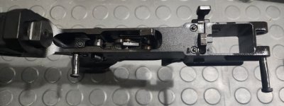

Lower Receiver. The Lower Receiver is also 7075T6 Aluminum Alloy, Type 3 Hardcoat Anodized to a mil-spec finish. The Lower Receiver Houses the Trigger Components and currently does not accommodate a Trigger Tech Cassette type Trigger. This is being remedied for the production rifles with the Trigger Pocket enlarged accordingly to accept a Trigger Tech AR15 Trigger. The Trigger Pocket is designed so as not to easily accept any illegal conversion parts. The Lower Receiver accepts any AR15 Pistol Grip with a Beaver Tail. Of note, there are 3 spring-loaded plungers in the Lower Receiver which exert upwards pressure on the underside of the Upper Receiver, thus eliminating any slop or movement. As a result, the lockup between the two receiver halves is extremely tight and rattle-free.
Controls. The controls on the R9 are mostly excellent for the Right-handed firer, however they are somewhat lacking in ambidexterity for “Lefties”. The Left-side Charging Handle is readily accessible, and could benefit from the folding mechanism that is being developed as an aftermarket add-on for the R18 Mk 3 Rifle. The Selector Switch is excellent, with a very crisp and definite operation. That said, the Selector Switch is Left-Side only and could benefit from being ambidextrous for the use of both Left and Right-handed firers. The Right-side Button Magazine Release is mostly useful for Left-handed firers, but is there for those “Righties” with hugely extended forefingers as well. The Paddle-style Mag Release is ambidextrous, being located centrally underneath and to the immediate rear of the Magazine Well. There is an adapter over top of the basic Paddle itself, which is designed to allow the operator to release a magazine with the push of a Forefinger. I personally find the Forefinger “Push” to be too far, and must break the grip of my firing hand to properly engage it. It is perhaps best used as a Thumb Lever to be depressed when manually stripping Magazines from the Carbine’s Magazine Housing. That said, I personally found the angle on the rear surface and bottom of the Thumb-lever to be off-putting, as the Lever caused a blister on my thumb after 30+ magazine changes. I would change the angle of the Rear and Bottom of the Magazine Release Lever to eliminate this irritant. The Bolt Catch is very Beefy and functions exactly as intended. Unfortunately it is also Left Side only. Strong consideration should therefore be given to creating an Ambidextrous Left and Right Side Bolt Catch identical to that found on the R18 Mk3 rifle.
Trigger. The Trigger on the R9 Mk1 is a single-stage, mil-spec trigger with an extremely smooth take-up and a surprisingly crisp break. That said, the Trigger pull weight averages 8 lbs 5 oz, which is excessive for both rapid and slow-rate, accurate fire. The R9 would greatly benefit from a Trigger-Tech style of match-grade trigger.

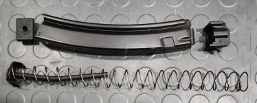

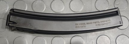

Magazine. The R9 Mk1 utilizes the MP5 style of magazine, albeit with the design altered to provide a last-round Bolt hold-open feature. A single 5/10 Magazine ships with the Carbine. Additional 5/10 Magazines and 10/30 “Pistol” Magazines are available for purchase at a cost of $65 per magazine, which is actually a very reasonable price for durable, steel Magazines. The Magazines are easy to load, being of the double-stack and double-feed design. Magazines are being manufactured on the basis of 5 extra mags per Carbine. If more are required, more will be manufactured.

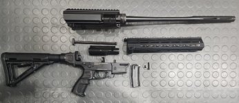

DISASSEMBLY AND REASSEMBLY:
The take-down procedure is extremely simple and intuitive and is covered in detail in the User’s Manual. There are no “tricks” per-se associated with the disassembly for routine maintenance. The User’s Manual also covers the Post-Assembly Tests that must be conducted to ensure that the firearm is functioning properly after it has been broken down and reassembled.

General. The R9 Mk1 impressed me from the outset with its excellent fit and finish as well as its overall “tactical” business-like appearance. This carbine is built like the proverbial “Brick Sh#thouse”, with an oversized, beefy Ejector Post and Bolt Catch. All of the components are designed and integrated to work well together. The oversized components suggest that long-term durability will be a strong suit of the R9 Mk1. The Carbine delivered flawless performance at the range, firing 300 mixed commercial rounds of 9mm without a single stoppage. Accuracy was perfectly acceptable, but would be improved with a lighter Trigger press. The ergonomics are excellent for a Right-handed firer, however the lack of an ambidextrous Bolt Catch and Selector Lever compromise the ease of use for those who are Left-handed. These oversights are easily remedied with a change of specification and development of an ambi Bolt Catch like that of the R18 Mk3.
MSRP. The MSRP of $1600 is excellent value for what you receive with the R9 mk1. Priced on par with the Skorpion EVO 3 when it was available, the R9 is clearly the superior firearm based on the quality of materials and construction alone. Are there less expensive options out there? Sure – the Kodiak K9 springs immediately to mind, but it is a rattly econo-brand that did not inspire much confidence in the firer when it was available. The R9 and K9 are not in the same league – not even close.
Final Recommendation. Based on my detailed inspection and initial firing session with the R9 Mk1, I highly recommend this PCC without reservation. Yes, there is scope to improve the ambidextrous ergonomics and the comfort of the Magazine Release Lever, but those are relatively simple and inexpensive fixes that can be incorporated into R9 production as “rolling improvements” over time. I suspect that the out-of-spec Buffer Tube was a oversight in SAI’s QC system, which must and no doubt will be immediately addressed. Increasing the size/depth of the Trigger Pocket so that it will accept a Trigger-Tech Cassette style of Match-Grade Trigger Mechanism may be a bigger challenge, which remains to be seen. Failing that, efforts should be made to source a lighter trigger pull that will still provide reliable ignition of commercial pistol primers. Those relatively minor points aside however, the R9 Mk1 remains an overall excellent, highly robust PCC design with advanced features (eg. Out-Of-Battery Firing Pin Safety Mechanism) that ought to provide owners with years of trouble-free service. If purchasing decisions are any indicator of value for dollar, I will be buying an R9 Mk1 just as soon as they hit the market. I cannot provide a higher personal endorsement than that...

1. A Trigger-Tech Trigger cassette will in fact fit within the Lower Receiver's Trigger Pocket. The problem right now is that the slot cut into the Bolt is too narrow to accomodate the width of the Hammer. As such a Trigger-Tech Hammer currently cannot contact the Firing Pin. The first 100 Carbines are boxed and shipping to dealers, so will not have this issue remedied. The installed trigger is nice and crisp, just a bit heavy for my personal liking. Owners of the first 100 carbines could have the Bolt Channel widened by a Milling Machine as an option if they absolutely insist on an aftermarket Trigger.
2. The Selector Lever ("Safety") is actually swappable from Left-Side-Only to Right-Side-Only, and is therefore ambidextrous, just not at the same time. Users simply need to undo the screws on each side and swap over the actual Lever and the Safety-Delete. Reinsert the screws and you are done.

7. Some of the several hundred 10/30 Magazines already manufactured won't lock into the Magazine Well on a closed Bolt. The internal pin that stops the Follower from depressing at 10 rounds was simply placed a touch too high up inside the Magazine Body. This has been identified and adddressed on a go-forward basis. The affected magazines will still function fine, they just need to be inserted with the Bolt held to the Rear by the Bolt Catch (eg. the normal method of reloading). Both of the 10/30 mags that I have on hand will not lock on a closed bolt, however this in no way interfered with my testing.

- Magazines are blocked with a metal post projecting upwards within the spring for the Follower to bottom out on at the 10-round mark. Behold, the mysterious inner workings of the R9's modified MP5 Magazine....
As you have brought up the issue of magazines, I can say that not all the magazines will work in an MP5. I tried several of the 30rd mags and most fit into an MP5 just fine , however one locked into the mag well but would not allow the bolt to go all the way forward. I haven't really bothered to investigate why but it would seem the mag sits too high in the mag well.
For sure this a secondary issue confined to those few who may buy a mag to supplement their supply of HK mags.
The way the mag is designed it would at least be easier to fix it so the mags will insert with the 10 rounds in it
Just need to file that "post" a bit.
