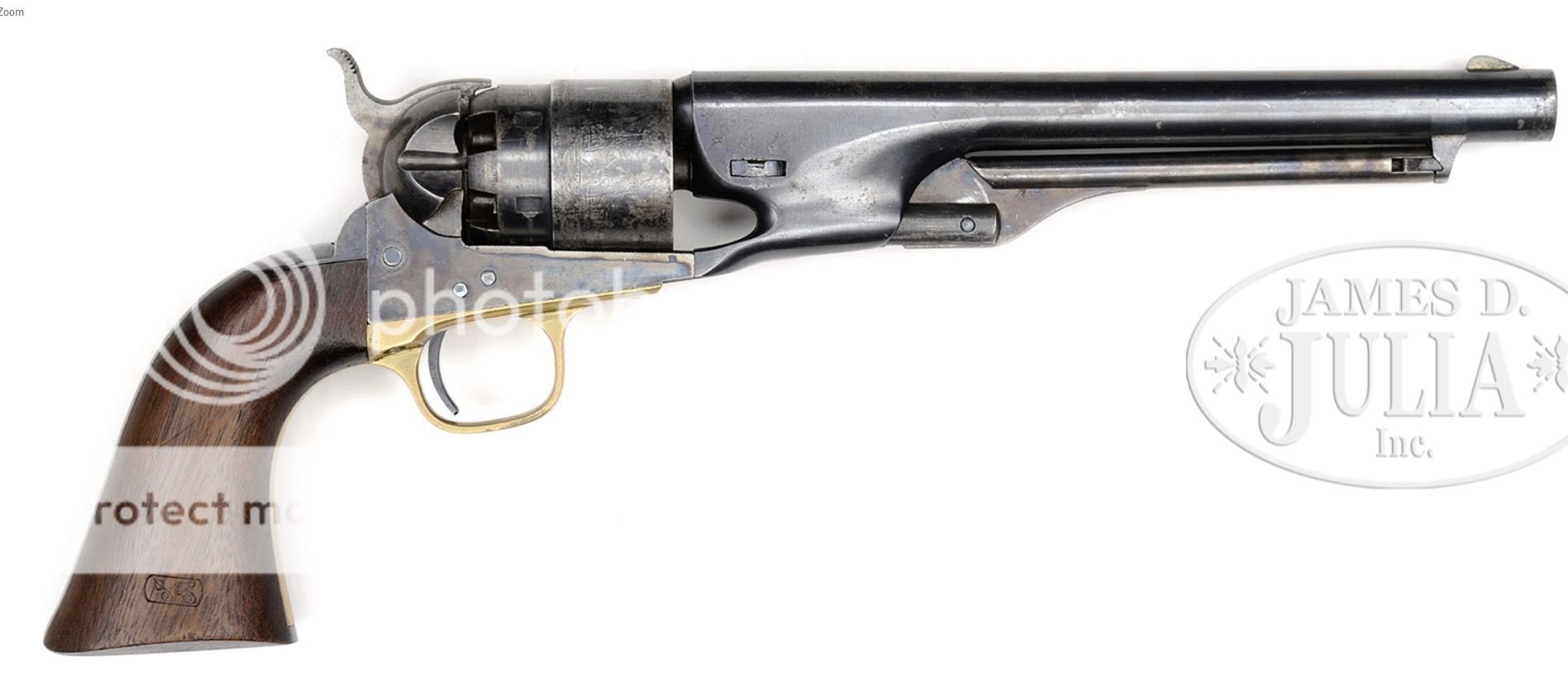

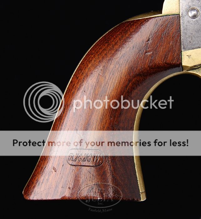

This Model 1860 Colt Army has both a JT cartouche for John Taylor as well as a CSL cartouche for Chester S. Leonard.
(I understand that this Colt S/n 48313 sold in spring 2014 for $25,300 including 15% buyers premium.)

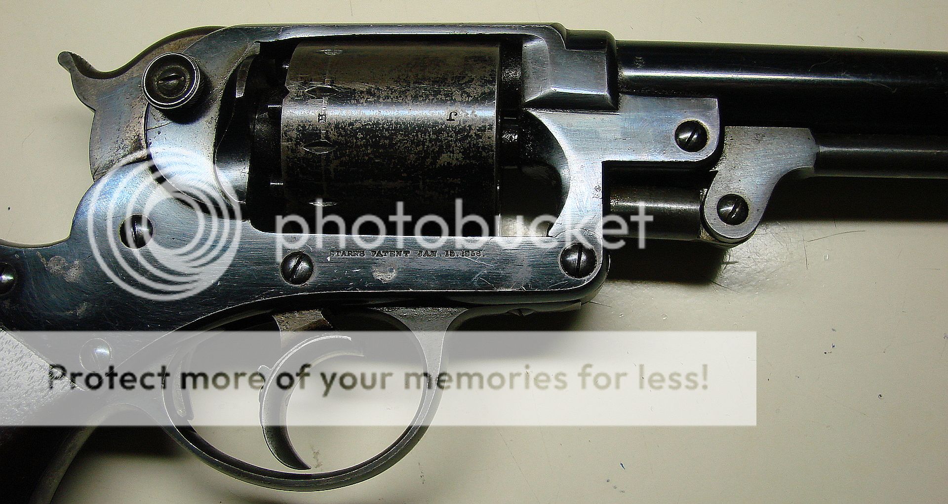

This Model 1858 Starr Army revolver offered on RIA has three cartouches---two CSL cartouches and one cartouche of JSD.
J. S. Duston was in Yonkers in November 1863 and undoubtedly later. (From Chales Pate.)

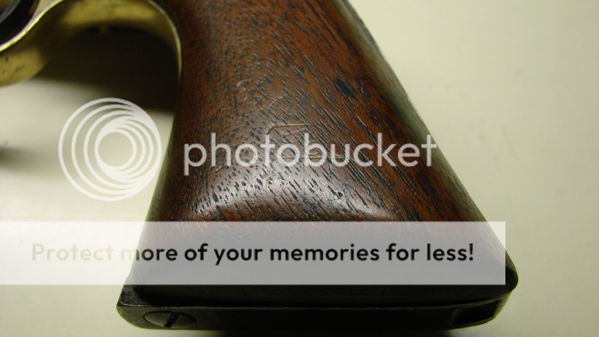

I went through this exercise because I have two Model 1860 Colt Army revolvers and one Model 1858 Starr Army revolver which has two excellent cartouches showing BH for inspector Benjamin Hannis.
