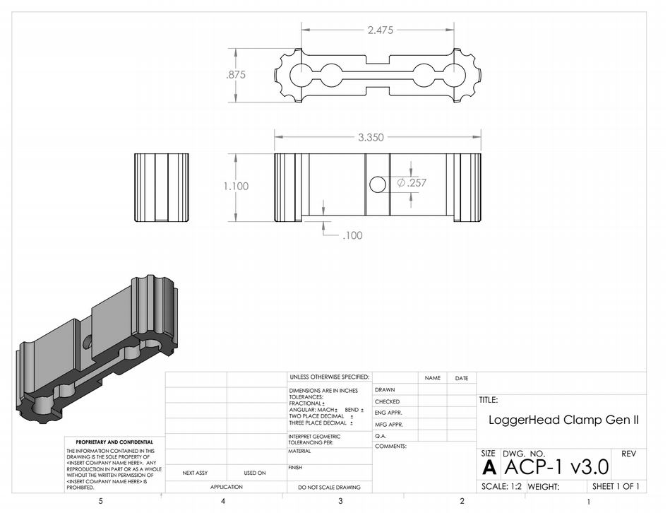

Hey, just happened upon this thread by chance. I'm on mobile right now, but I'll link to my install thread in the morning. The Loggerhead ACP hardware is a great little piece of kit, and very affordable. Several months after the install, I am loving it, and would do it again if I got another rifle. Having the correct comb height is very important for precision shooting, and it has made a big improvement in my consistency.
You can order direct from their website, which is admittedly pretty outdated, or email him like I did to make the deal. Very good guy to deal with.
Feel free to ask any questions.

I found your old thread and the link to snipers hide about the install. Looks like a good product. I can't seem to get the dimensions of the pieces, on the website, the links don't open for me. The stock I'm looking to modify is relatively thin, only about 1.25". I would be interested to know if anyone has installed one of these into a wood stock? Seems it would take a lot of milling to install it.

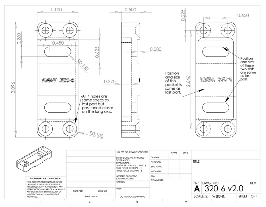

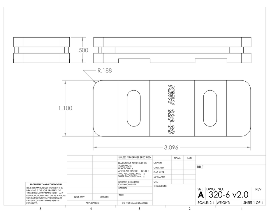

It really depends how the stock is made and what you can shoehorn into it. I have a number of different mechanisms that I have designed that will work. If you tell me what the stock is made of and the dimensions and any lightening holes I may be able to make a suggestion.
The stock is a factory Tikka M55 Sporter. Solid wood stock. It is 1.2" thick at the front edge of the comb where I would cut it, and at the rear it is 1.4"
