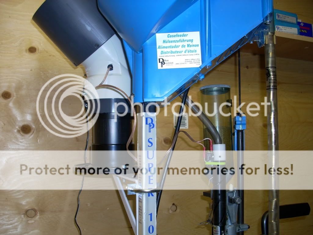

The kit came from Double-Alpha Academy in Netherlands and it looks like they didn't include a plastic PVC link pipe connecting two sections of PVC pipes forming the stand. There's a photograph on Double-Alpha Academy site showing the bulletfeeder resting on the bench next to the 1050 on that plastic stand consisting of the two sectiions of PVC pipe connected by a larger diameter link section in the middle (which is missing). How do you hang it on the casefeeder? By the L-bracket provided in the kit?
There is a new kit coming in June/July that allows it to hang from the case feeder. No idea if it is backwards compatible but I expect it will be.
Otherwise you use the l-bracket and short pipe I see in all the photos.
Yep, the base of the casefeeder is bolted to the L bracket, and the L bracket is bolted to the casefeeder stand with the supplier U bolts.
