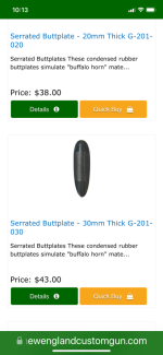

I ordered a butt pad for one of my guns and the one I chose, has no screw holes. I would LIKE to have the screws blind if possible. I have zero experience with butt pads but am adding this one to increase the LOP. Is it possible to make the screws blind and if so, how?
I'm assuming that there are no pre-drilled holes because it gives the most options for installation in terms of simply gluing a rubber plate to the end of a (hardwood) buttstock, drilling to match spacing of any existing holes or to select one's own hole spacing to shape the rubber plate accordingly.

Ignore the thread title, the OP purchased a buttPLATE. Normal methods for pads won't work.
Yes and no. Yes it is technically a butt plate, however, since it is over 1” thick and is a solid rubber compound, it is more like a recoil pad than what we typically call a butt PLATE. I worded the title to try to avoid confusing this 1” thick rubber “plate” from an 1/8” hard plastic or horn plate. Being >1” thick and rubber, it is more like, and should mount like a pad. At this point, I think I am going to epoxy it on. Not crazy about making it permanent but still don’t see any way to use blind screws.
It is a buttplate, it is not a pad. It does not even come close to a recoil pad design. It is a buttplate, just a thick one. Recoil pads also come in different thicknesses, from very thin to very thick. A thin pad does not become a plate just because of thickness. Even your own pic in Post #3 calls it a buttplate, and calls it a buttplate four times, pad is mentioned zero times.
in post three, where I posted the picture I clearly stated “it’s a butt plate not a butt pad….”. So, prior to anyone posting suggestions, I clearly posted that it is a plate AND provided a picture. Again in post 5 I CLEARLY stated that it is a butt plate not a butt pad. Perhaps, before forming an opinion or making a post, you should read more than the title.
