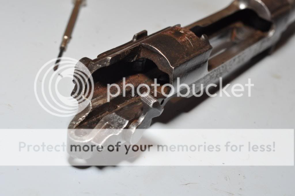

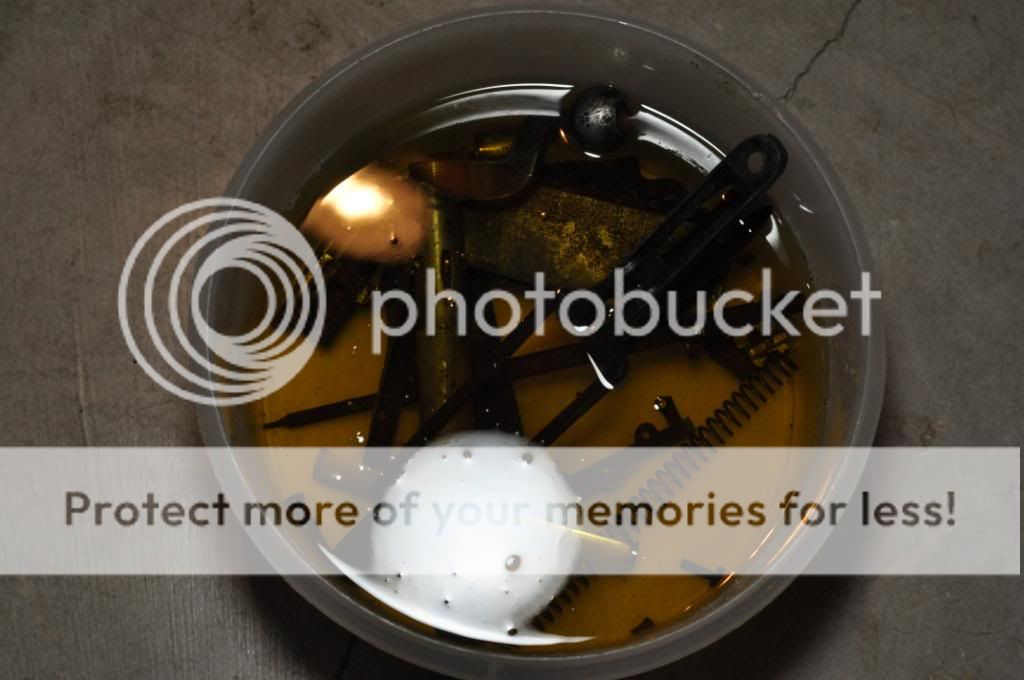

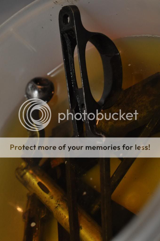

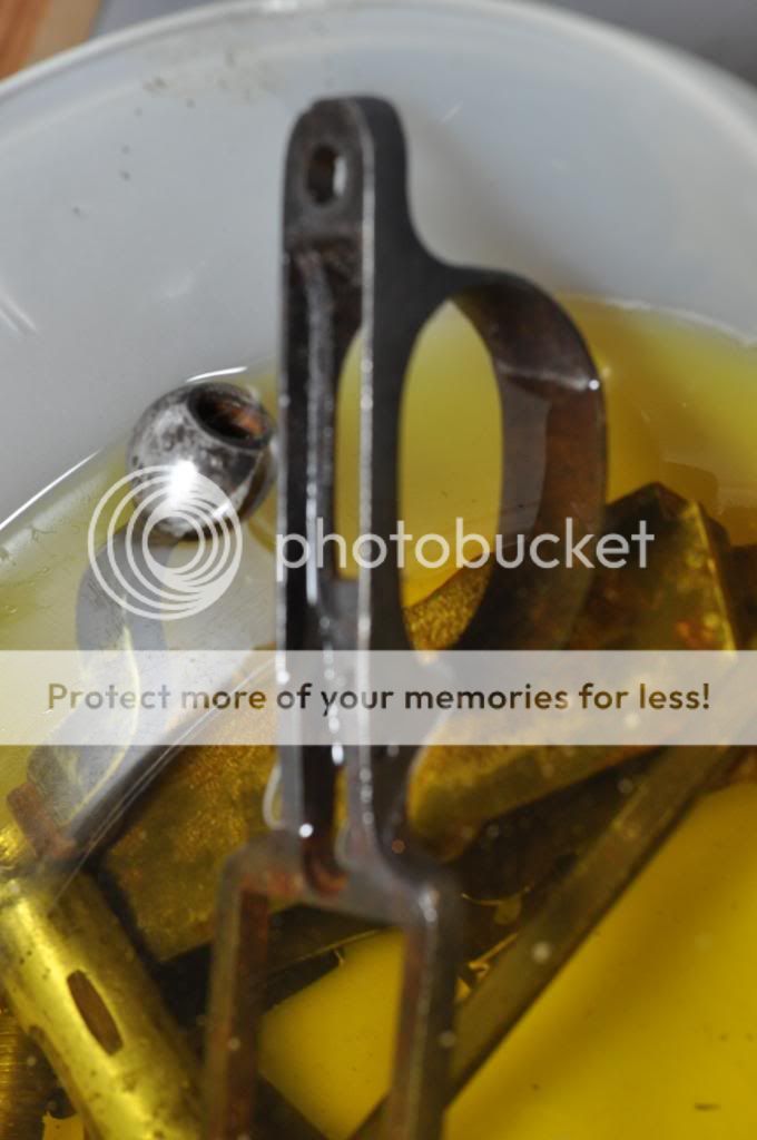

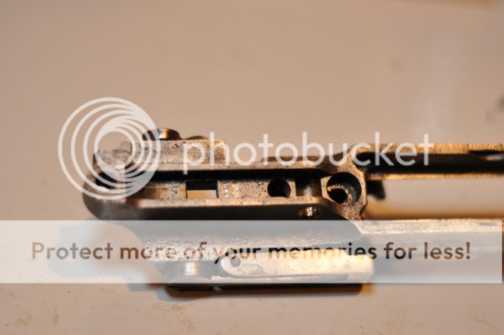

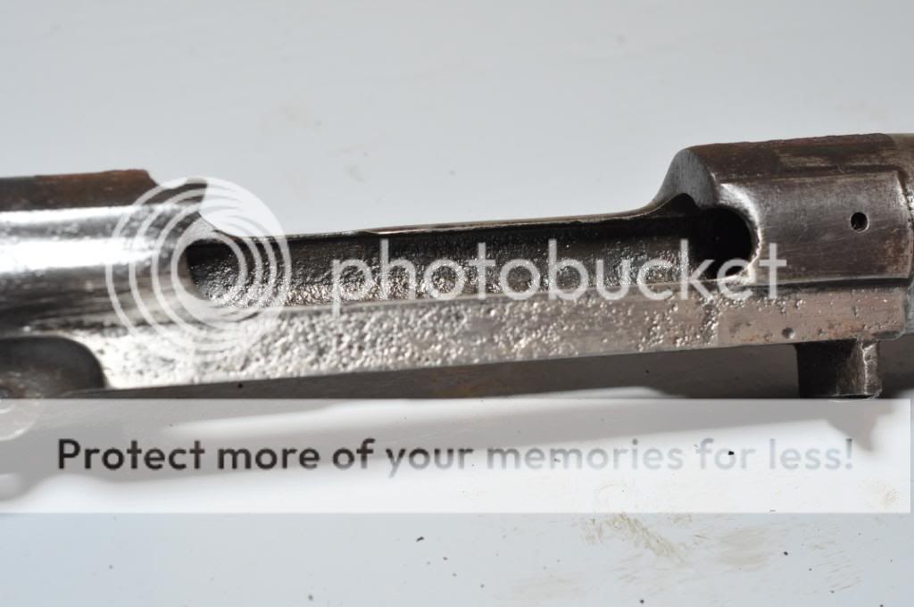

so here it is and it looks alot different than most i have seen pictures of mostly the safety and the bolt handle, but the bold comes apart just like a Mauser. i hope some of you can shed some light on this rifle. its pretty rough the pitting is sorta deep so i need to find out if this kind of damage on the receiver is a safety concern. the barrel has damage at the end that i believe is unifiable but it only goes about two inches deep at the most so i think i will have to have the barrel cut and re crowned. i have all the parts sitting in a rust remover and the action and barrel will be going tomorrow and i will try and get some better pics. i appreciate all the help and info given on here.
it was very abused but the chamber and 80% of the barrel are in good shape so my only worry is that the damage to the receiver is to much to be safe the rifle actions very smooth for the shape its in.
