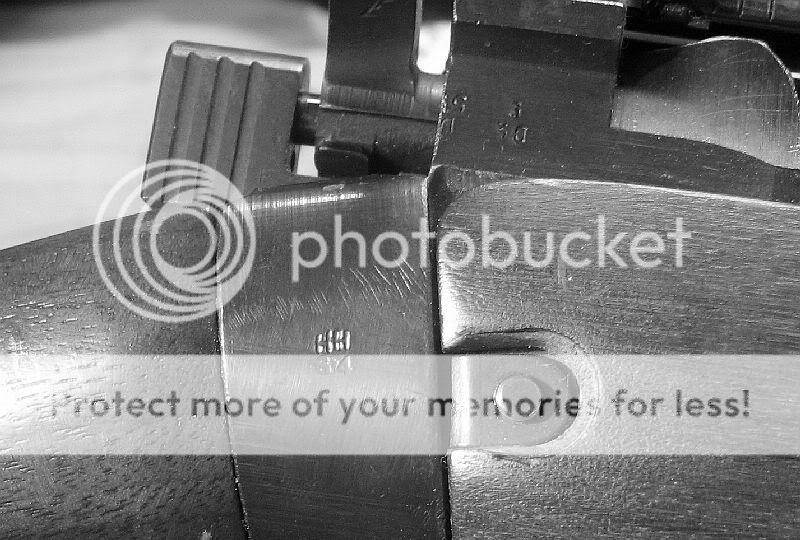

Here's a picture of the one I have.

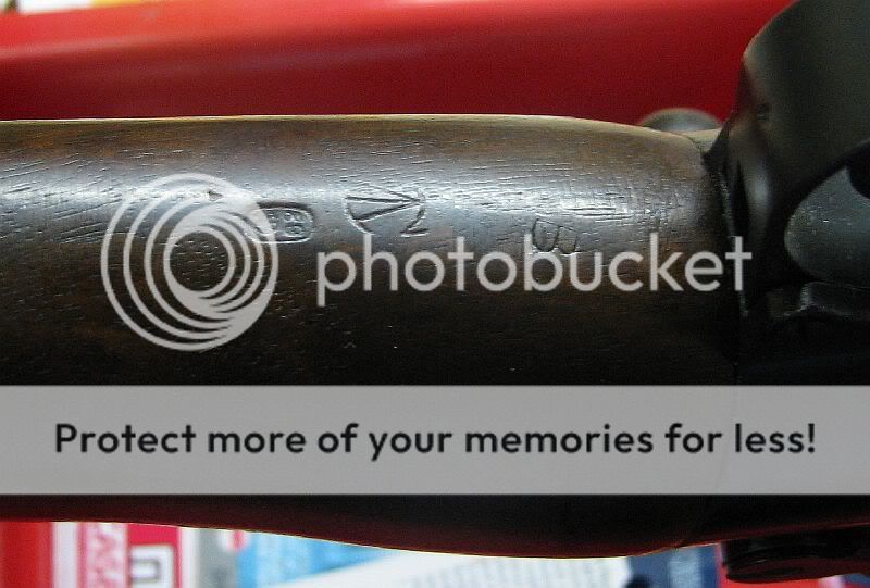

Here's mine. Sorry, a little fuzzy.... sort like me!:p
Your rifle is a Fazakerley, This can be determined by the relief cut on the left side, but the true indicator is the straight sidewall angle only found on Fazakerlies and post 1943 Long Branches.
If you wet the receiver with oil and change the angle toward the light you will almost certainly see the original manufacturers and possibly the serial number e-pen engraved on the left side wall of the receiver.
