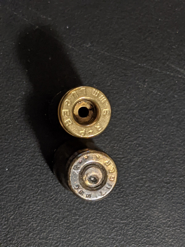

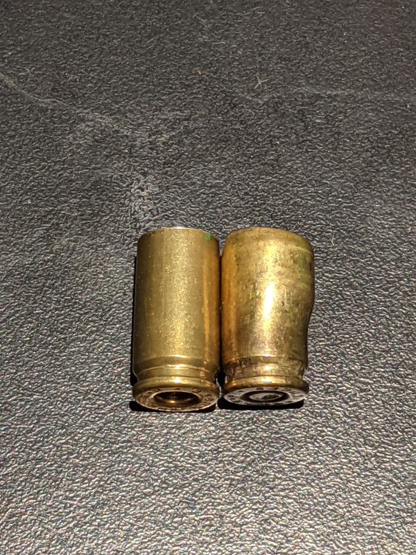

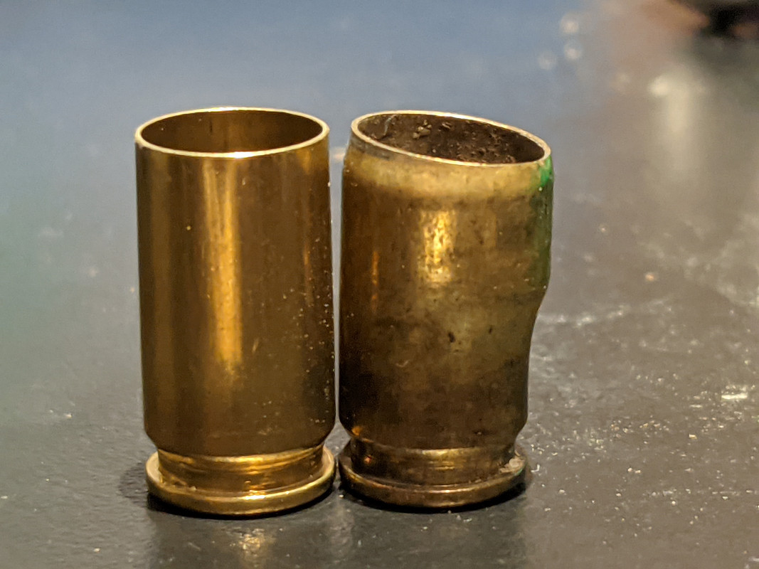

I've picked up .380 fired in 9mm, 9mm fired in .40, .303 Savage in .303 British, .308 in .30-06. If the extractor holds the case back against the breech face, the round will fire.
