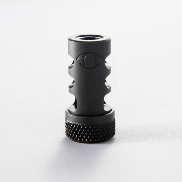

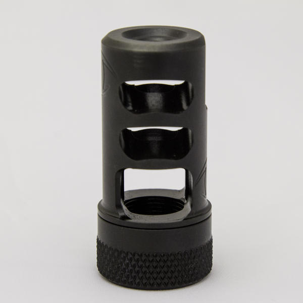

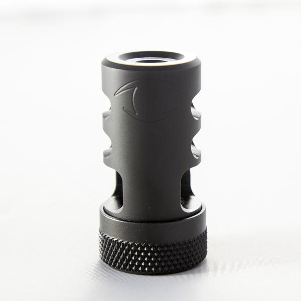

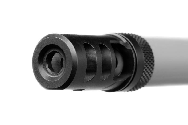

We would like to introduce The Heathen-Lite Muzzle Brake !
The exact same design and dimensions that have made this brake famous.
Made from Aluminum Alloy and a proprietary surface-hardening, this brake reduces the weight of its steel counterpart by nearly two thirds!
We have been running this brake in comps for the last year as well as testing on rifles up to the 300 Norma with excellent results - This is exciting news especially for the guys wanting to save weight on that Carbon Fiber Wrapped-barrel light-weight hunting rifle.
This is a weight comparison of our original steel brake and then our Heathen-Lite:
std steel
.750 dia Heathen = 2 oz / 54g
.885 dia Heathen = 3.2 oz / 90.7g
.995 dia Heathen = 4.5 oz / 127.5g
Heathen-Lite:
.750 dia Heathen = 0.7 oz / 19.9g
.885 dia Heathen = 1.1 oz / 31.2g
.995 dia Heathen = 1.6 oz / 45.4g
