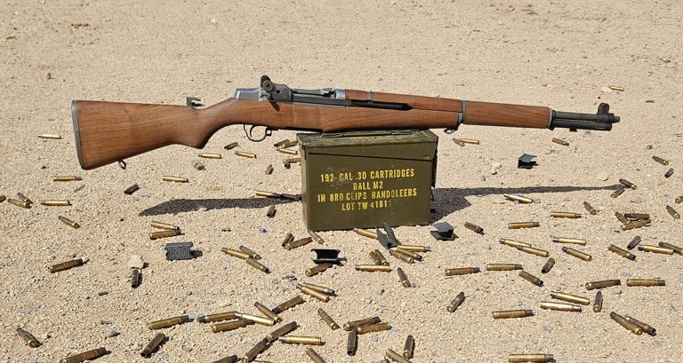

Introducing the M1 Garand by CMP: A New Chapter Begins!
All military Garands produced by Springfield Armory, Winchester, International Harvester, Harrington & Richardson, Beretta and Breda featured forged receivers. These were all put thru the stringent military proofing, gauging and testing processes and can be found in good condition and at less cost than the new CMP rifles.
Maybe pre COVID for a beater, a modern repro or a frankengun, but they wouldn't be offering these if there wasn't a business case for them.
