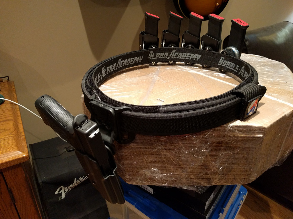

Here is mine for reference. I had an AR pouch because of 3gun so image it's not there. I have a stinger holster 3 Ghost double stack pouches and 2 magnetic pouches. So far it works for me.

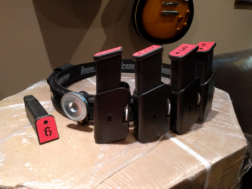

Here's my current rig,
Strong side holster (CR SPEED) Fits my Shadow and my Shadow 2 without any adjustment needed.
4 CR speed mag pouches. 1 magnet on the front of the first pouch.
A second magnet on the back large enough to hold 3 mags, but I generally only carry 2 there.

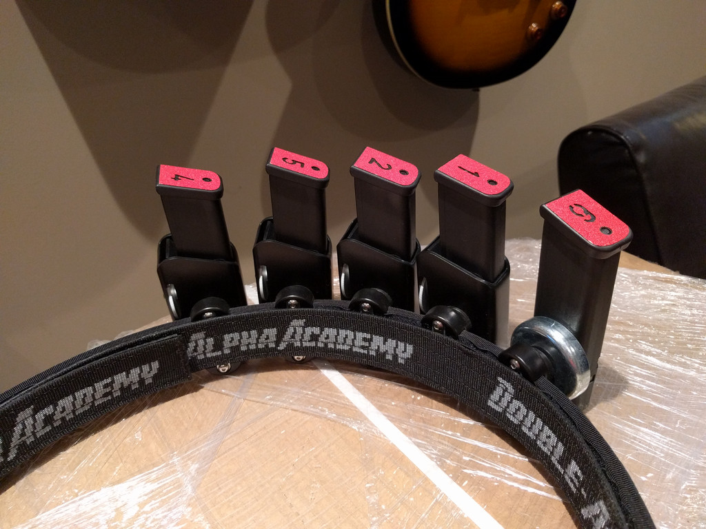

And a buttload of extra mags, because there's no such thing as too many mags!
