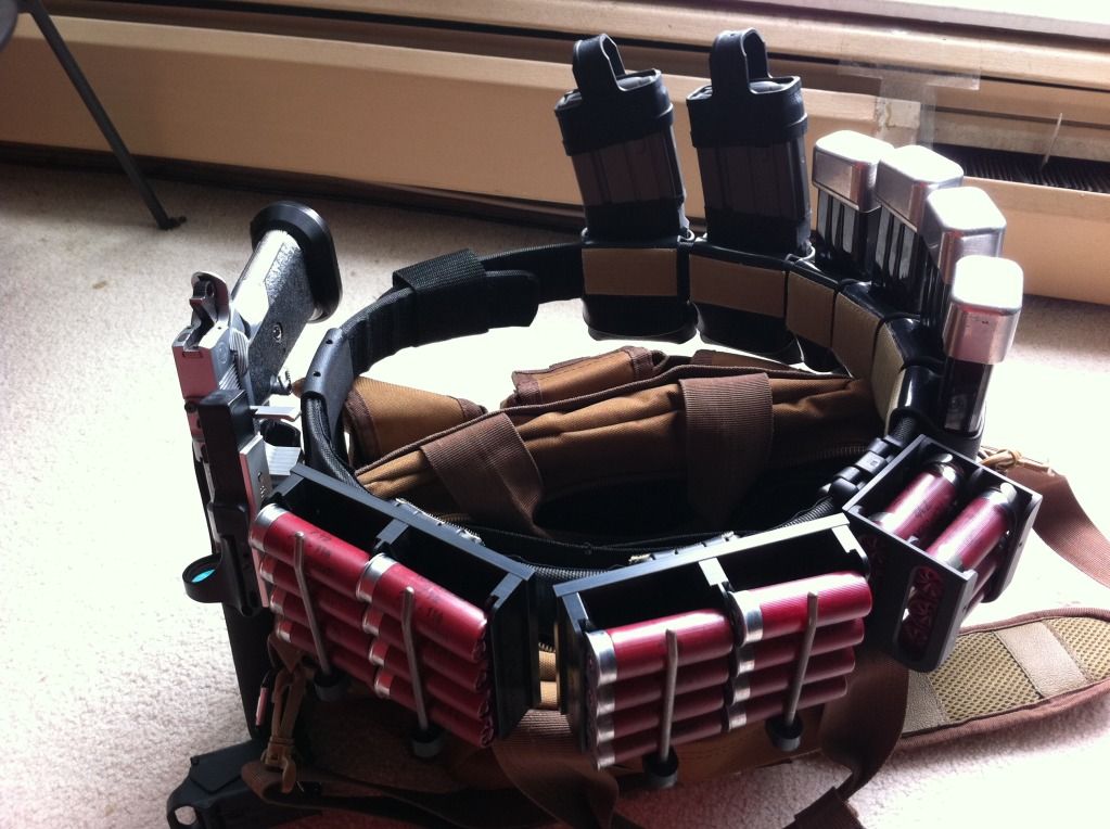

My 3-gun belt setup is 2 FSL-8 and 1 3x3 shell caddy. I like the way that setup works, as it means I can put the odd slugs in a different caddy.
This here is my 3-gun belt:

You have a choice of attachments from Carbon Arms and I think the Tech-Lok is the best. I can take it off easily if there is a stage not requiring shotguns and I need to go prone for rifle...etc.
Or are you referring to the tan velcro I stuck on the inside of the attachments? That's to stick to my inner belt since there's so much kydex/plastic in the way that the outer belt would otherwise barely be attached!
