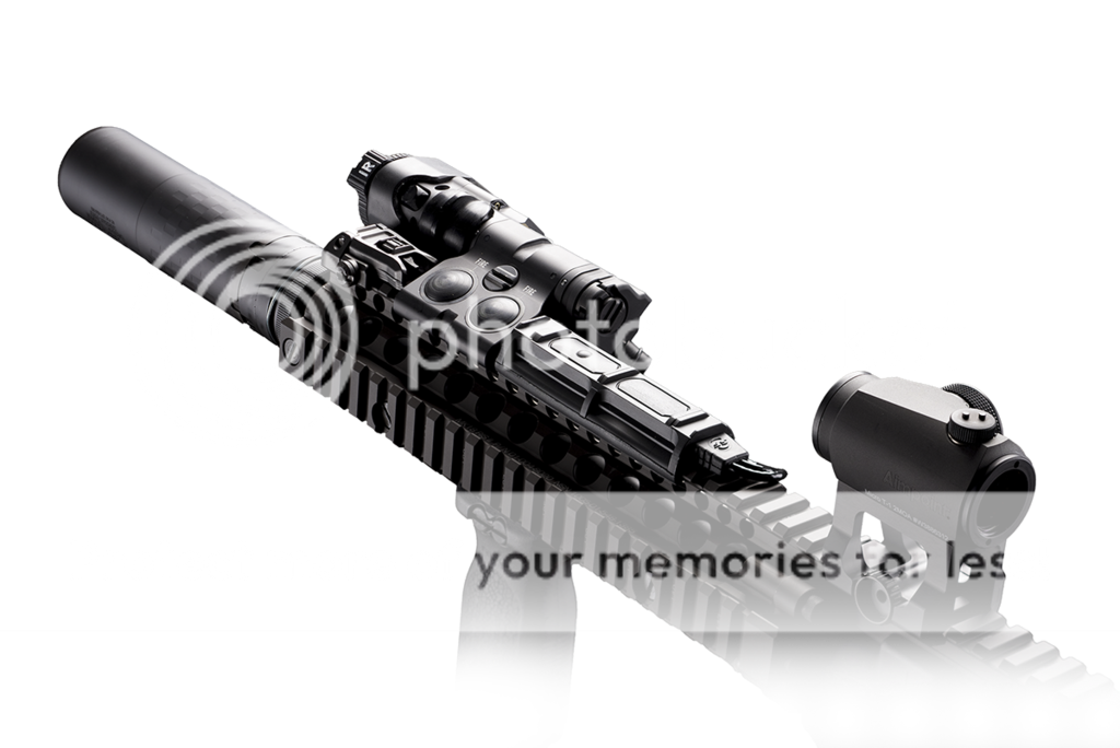

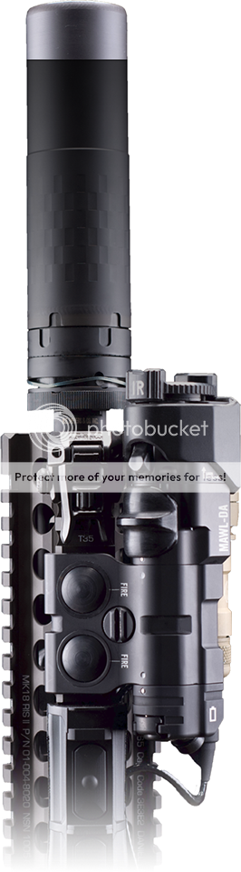

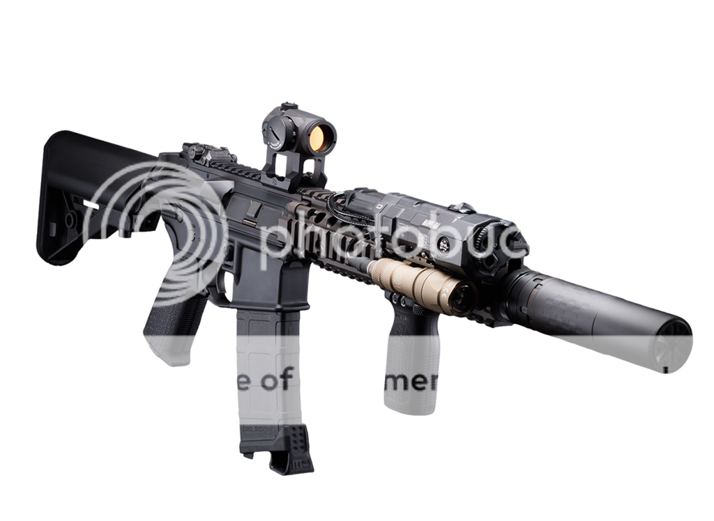

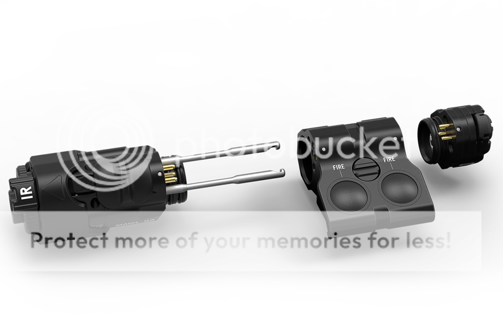

B.E. Meyer MAWL-DA addresses all the issues that end users have identified with the PEQ-15 & DBAL units,MAWL-DA eliminates granular illuminator adjustment and complex multi-position switches and instead consolidates these choices into the settings you need: Close Range, Mid Range, and Long Range, with the power and divergences appropriate for each. Bad news it's not available for sale ... Class IIIb Laser
gadget
The MAWL has my attention, I'm not exactly sure how I would convince work to get some. I'd love to try one and push it up for eval.
