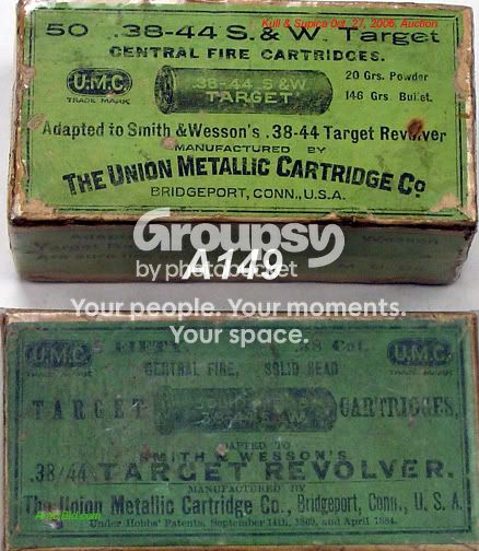

The original 38-44S&W was a 1.5" case with a .356 cal bullet loded completely inside the brass...nothing protruding from the top. The chamber was bored straight through and the case was intended to run the full length of the chamber to take up the lack of "step"
I used to have a pic of an original cartridge but no luck finding it...here's a pic of an original box...
I have a de-registered 32-44 S&W target . The 38-44 S&W is also considered antique just checked the FRT. it lists them as antique.
