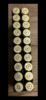

I’ve seen very poor and dangerous results with a Sako 90 in 308 just this past weekend using the Superformance loading from Hornady. Gun was bought new and hunted with last year. Fellow ran low on ammo and couldn’t find the Federal premium he was using so picked up the Hornady to try. Groups were 3-5” at 100yds with stiff bolt lift and clear signs of high pressure. The crazy bugger and his hunting gang fired the entire box. Buddy sent me picks of the empties and asked if he should just shoot the rest of the boxes for the brass,haha of course I told him not to shoot anymore and find some of the Federal that he was using previously. IMG_2685.png
