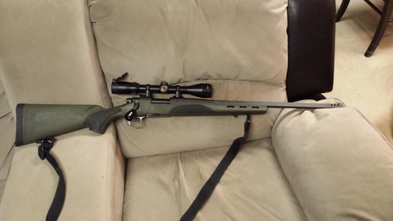

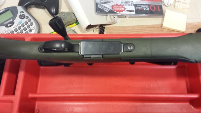

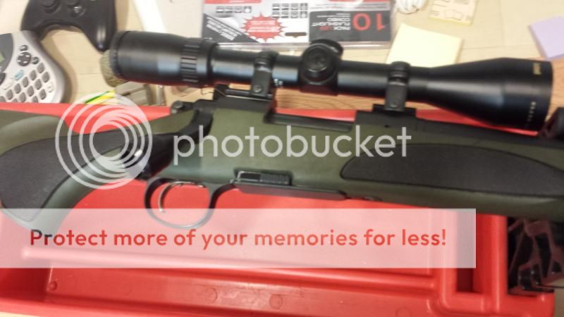

I got a decent deal on my 700 last fall at Ellwood Epps, I really wanted detachable magazine, but at the time they had no black synthetic stainless steel with detach. so I settled for the drop mag. After some shooting, the drop mag is a total pain in the neck.
My question is; without changing the stock, and hopefully using remington parts. Can I convert the rifle from drop to detachable mags?
