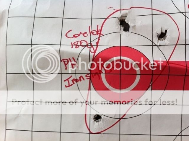

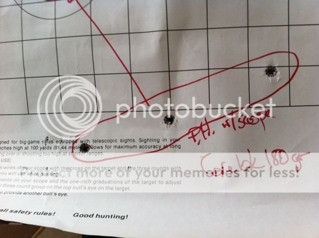

At the range yesterday trying to figure out why I can get a group. Three down the range at 100 yards and second and third shots progressively move inch higher and 2 ½ inches to the right so first and third shot end up 5 inches left to right spread and 2 inches higher. I took scope off and put three shots in a 3 ½ x 2 inch group with iron sights.
Does this indicate a bad scope and if so any idea the cost of a typical scope repair?

Yes iron sights, that's how I got the second group, not the best group but one shot with glasses off(see the sights but target blurry) and two shots with glasses on(see target but sights blurry).

Yeah everything is torqued and this wasn't first trip to the range trying to figure this out, I've shot every good groups with same rifle and same ammo in the past. Other "groups" have started here and ended up 5 or 6 inches to the right or high or low. I won't claim to be a sniper but if I can somewhat group 3 with poor eyesight and iron sights I should be capable of better with the scope.
I agree - results are inconclusive. One possibility is that the scope is "walking" - as many do after a turret adjustment. In this case, the scope settles down after a few shots. I've has this happen with some pretty decent scopes, particularly in cold weather.
i would go with dead scope. your open site grouping is fine. mount a known scope and try again. if the rifle groups your scope is done.
Sounds like you should take it all apart, and put it back together. That way you know nothing is loose. If the scope still can't be zero'd its the scope thats the problem.
