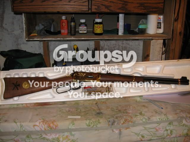

figured out the pic thing
http://[IMG]http://i228.photobucket.com/albums/ee103/swift5337/44-40002.jpg[/IMG]
