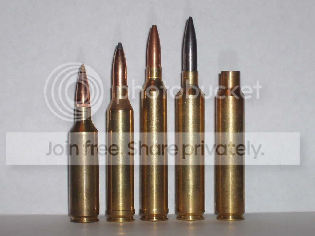

I know this is no 6mm... But how about a 6.5mm Allen Mag
Some of the modern high performance members of the 6.5mm family
Left to Right: 6.5mm W.S.M., 264 Winchester Magnum, 6.5mm S.T.W., 6.5mm Allen Magnum and 338 Remington Ultra Magnum case which is used to form the 6.5mm Allen Magnum. The 6.5mm A.M. boosts velocity by 200 fps with all bullet weights.
Parent Case: 338 Remington Ultra Magnum
Recommended Bullets: 100 and 120 grain Ballistic Tip, 130 and 140 grain Accubond, 142 gr Sierra Matchking.
Recommended Powders: Ramshot Magnum, H-US869, WC-860 and WC-872
Recommended Primers: Federal 215 Large Rifle Magnum
Velocity Performance:
Bullet Weight Muzzle Velocity(30" barrel length)
100 gr. 4100 fps
120 gr. 3800 fps
130 gr. 3700 fps
140 gr. (Accubond) 3550 fps
142 gr. 3550 fps
Ballistic Performance:
Bullet Weight: 120 gr Accubond @ 3800 fps, 250 yard zero, 10 mph
Yardage velocity wind drift Energy TOF(sec)
400 2879fps 8.4" 2209ft/lb 0.363
600 2484 20.1 1644 0.587
800 2122 38.3 1199 0.849
1000 1794 64.6 857 1.156
Bullet Weight: 142 gr. ULD RBBT @ 3550 fps, 250 yard zero,10mph
Yardage velocity wind drift energy TOF
400 2863 fps 6.8" 2584 ft/lbs 0.376
600 2549 16.1" 2049 0.598
800 2255 30.4" 1603 0.848
1000 1978 50.6" 1233 1.132
1200 1714 78.2" 926 1.458
Recommended Uses: The 6.5mm Allen Magnum is designed to be a dedicated hunting round for use on light to medium big game at moderate to long range. With 100 to 130 gr bullet weights, the 6.5mm Allen Magnum is extremely flat shooting but the heavier 140 and 142 grain bullets perform better ballistically at long range. The 6.5mm A.M. is not intended to be used as a high volume varmint round.
Effective Range: When using 100 to 130 grain bullets, the 6.5mm AM can effectively harvest light to medium big game species out to 600-700 yards with easy. With heavier, higher BC bullets, it offers legit 800 to 1000 yard reach on pronghorn to smaller deer species.
Pros: Extremely flat shooting, good selection of commerical bullets, very low recoil.
Cons: Cases are somewhat involved to form, barrel life is relatively short and suitable reloading powders are somewhat limited.
