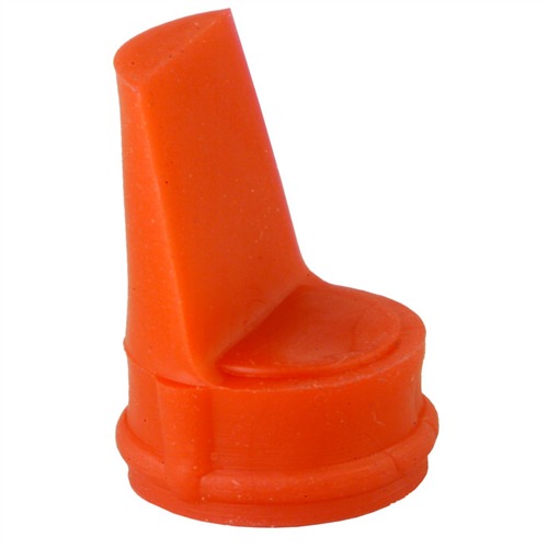

AR-15/M16 ACCU-WEDGE
* Manufacturer:Z-M WEAPONS
* Price:$4.99
* Instantly Tightens Loose Upper & Lower Receivers
Helps promote better accuracy by making the upper and lower receiver fit tighter. Open upper receiver; drop this long-wearing, rubber wedge into the rear of the lower, behind the push pin. Absolutely no modifications required.
SPECS: High-density, thermo-plastic rubber, ½" (12.5mm) long.
Brownells catalog page 68
993-150-100
ACCU-Wedge
