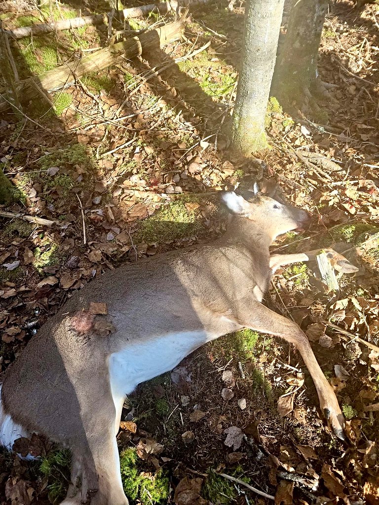

Yesterday I pulled the trigger on a small doe.
First shot was not the greatest due to angle and entry was just behind rib cage(liver) and exited through stomach.
Deer ran around and dropped 30 yards in front of me. Watched her and saw her drop her head. Now I’m thinking she has expired so I get up and start walking towards her. At about 20 yards she stand up and is straight in front of me.
Quick second shot through front chest and she drops 10 yards.

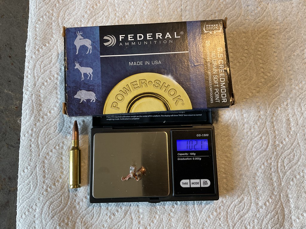

Now I was able to recover the bullet that travelled through the chest, through the internal organs and ended up lodged high on the thigh touching the skin.
I know these are not premium bullets but my question is , is 38 gr loss (about 25%) or 75% retention good considering this bullet was at max speed and dumped all its energy in the deer.

It does not take much to kill a small doe. This bullet was adequate for that task.
If you were hunting a larger animal, it might be found "wanting"
The 6.5 Creedmoor is not a particularly powerful round, so bullets that would be
fragile at faster speeds, may work acceptably in the CM. 75% retention is quite
good for a C&C bullet at close range. Dave.
Personally, I believe the bullet did a very good job, being that it is not classified as a premium bullet. A broad-side shot is the most desired, an oblique shot which opens stomach contents is unpleasing. Congrats on your kill, skill and marksmanship, you will have a great memory and many tasty meals!
Sample of one, meaning it doesn't show much as far as what can be consistently expected. The Creedmoors moderate velocity and the heavy for caliber nature put things in favor of the bullet penetrating well. I'm a little surprised it retained as much as it did.

75% retention from a budget ammo is pretty good.
Congrats on your hunt :)
As others have said 75% weight retention is pretty darn good for a cup and core bullet. When I tested the same brand of ammo in my 270win vs water jugs I only got like 78gr of 130gr retained, or 60% retention.
High weight retention is the most over-rated aspect of bullet construction that there is. Fact is; as long as you get enough penetration the more weight a bullet a bullet loses the better. That missing weight doesn't just disappear, it goes to work for you opening a wound channel that a 100% weight retaining bullet simply can't do and will never be able to do.

6.5 is fast. Some times if you miss mass..you will poke a hole straight through. Recovery weight is good for the bullet type. Enjoy the meat.
A 140gr bullet from a 6.5. Creedmoor is not fast and no, it will not just poke a hole if it was going “too fast”.
Bullet worked fine, and as is was supposed to under the conditions.

I wouldn't be too worried about the bullet weight retention or expansion of this cup and core bullet; it did good.
IMHO, the bullet did it's job very well, especially at such close ranges.

From the look of that bullet, it appears to be a Speer Hot Core, which is a very reliable C&C bullet. I've used them for years, when I can find them, along with Hornady and Norma offerings. I use other manufacturers products as well but those are my three mainstays.

Your second shot was the real proof in the pudding concerning the suitability of the bullet. 20 yards is basicly point blank and muzzle velocity is about as fast as it's ever going to be. It would be fantastic if all bullets stood up that well.
You don't mention whether or not you hit bone in either shot. That's when the real test of a bullet is put to the extreme at close ranges.
One thing I should mention, Federal, like most ammo manufacturers, buys the cheapest bullets available for their Blue Box loads. There is no guarantee that the next box you purchase will be using the same bullets, powder or primer.
That doesn't mean the bullets won't do the job, just not quite as well under similar circumstances.

I’ve used federal blue box for hunting deer more than anything else, it shoots well in a couple rifles and the price is reasonable. I’ve never recovered a bullet but the exit hole and blood trail has been evident that it performed well with minimal meat lost. I like the Speer Hot Core as far as cup and core goes, so far zero complaints. Yours looks like it did the job fine, as always shot placement is a key factor.
